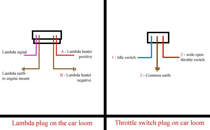

Ok...i think i may have found a problem with my car...im just hoping to god someone can confirm that the below is wrong...and something isn't right.
Ok...Car ignition off and everything as it should be except disconnected plugs.
Lambda plug on left...Throttle switch plug on right.
I have continuity from:
1 to A
1 to B
2 to A
2 to B
3 to A
3 to B
If any g60 owners could please just pop off your lambda plug and throttle switch plug...then test for continuity from each pin on throttle switch plug to lambda.
It would be cool...but hopefully someone can confirm the above isn't right.
Please god tell me ive found my problem? :o :D

Any idea on the above? Sommet dosnt just seem right to me? :?
Could anyone please perform the above continuity test?
Its only a quick and simple one...and could potentially put an end to a 2 year problem ive had with the car.
Unplug lambda and throttle switch plug.
And just test from>>> each of the 3 throttle switch pins to>>> each of the 2 lambda heater wires on lambda plug.

Right - gonna do this now - there is no way that should be correct IMO...
Did you have the ECU plugged in??
Back in 10...
Riley - With the ECU unplugged I get nothing - I think that proves there is not a wiring fault or none of those wires are making contact in the loom...
With the ECU plugged in I did get readings but all we are doing is looking at the ECU circuitry - as my car is knackered tho it would be good for someone else to do this to compare...
1 to A 692 Ohm
1 to B 698
2 to A 692
2 to B 689
3 to A 3.0
3 to B 0.4
