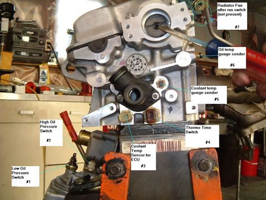

Put a bid in on e-bay for what i thought to be a new ECU coolant temp sensor (number 3 on below picture) and won it.......what the sensor actually turned out to be was a thermo time switch (number 4 from the pic)!!
Wasn't too fussed as i want to change most of the sensors anyway, so earlier today i went out to fit it and to my surprise i found that i didn't actually have this sensor on my car...just a bung where it should go..
So just out of curiosity really i'm wandering why my car doesn't have this "thermo switch" when ETKA says that the KR and the 9a do...
that 'famous' pic is for a US spec 16v I believe (PL?) so the 9A may be different. The 1.8 has 3 of the small black topped sensors and the thermo-timeswitch I don't think the 9A has 3 of the small sensors.
