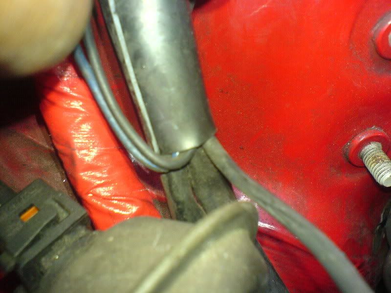

waynos 0 Posted August 8, 2007 as for the fan running on , check around the airbox for a brown wire(may have black heat shrink tubing around it. If iyou have one and its touching the body, when you turn your car off the fan wont stop.had exactly the same thing happen to mine.just taped it up and put it out the way. its supposed to go to a temp sender on some models but mine doesnt have it there where the wire comes from( seen leading off the bottom right corner) heres the bastid wire! Quote Share this post Link to post Share on other sites

Rod 1 0 Posted August 8, 2007 your a good man. fan problem sorted, thanx.... any ideas on the rest of the issues :lol: Quote Share this post Link to post Share on other sites
