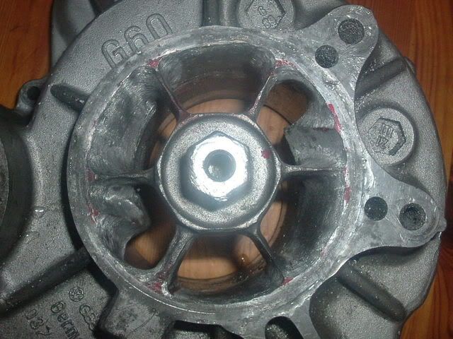

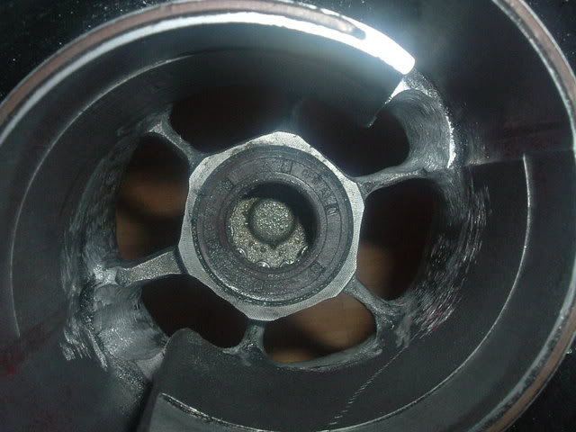

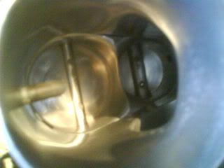

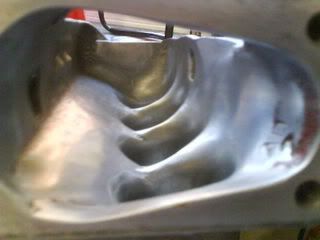

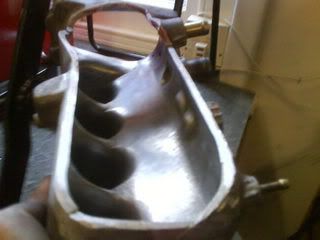

flusted 0 Posted August 18, 2007 ive ported everything i possibly can inc cutting my inlet manifold open and doing the inside! just finished doing my own charger aswell Quote Share this post Link to post Share on other sites
flusted 0 Posted August 18, 2007 my mate welded the inlet manifold back up for me Quote Share this post Link to post Share on other sites
flusted 0 Posted August 18, 2007 thin cutting disc and a grinder. my mate welded it up easy aswell. Its good to bolt the throttlebody on it when its open and you can see loads of lumps n bumps that can come out. I also opened up the ports on the inside a bit and shaped them the direction of the airflow Quote Share this post Link to post Share on other sites
