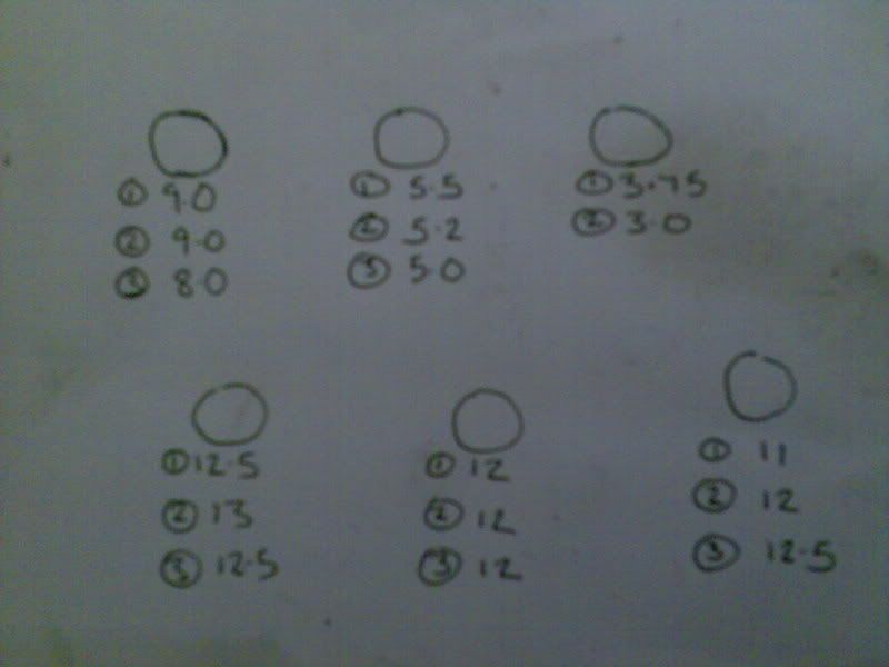

ziderapple 0 Posted January 27, 2008 Carried out a compression test this evening, was quite pleased with the results on three cylinders, ok with one and gutted with two (can you guess?). I did three tests on each cylinder, except the last one, didnt see any point doing a third. Results: Does this look like HG failure? My brother is off work tomorrow so is going to try and trickle some oil down the bores with poor readings and re-try, think they'll be the same though. Gutted. :( Quote Share this post Link to post Share on other sites
CorradoVR6-Turbo 0 Posted January 27, 2008 hmm not good bud,it could have slightly blown the gasket between 3 & 5 only by carring out a leakage test will you fully know if its the valves,rings or gasket. Your hole back row is low..? 1,3,5 mabey the rear banks have run lean? But which ever way you look at it....its time to open you tool box :( Quote Share this post Link to post Share on other sites
ziderapple 0 Posted February 23, 2008 Just tried putting some oil into cylinder 5 and re-testing. 14 bar.......... :( I guess I need a new bottom end? Gutted. Quote Share this post Link to post Share on other sites

CorradoVR6-Turbo 0 Posted February 23, 2008 Bad news bud,get it pulled apart and find out whats up,it could still be gasket? but you have to pull it apart....dont get down mate she is testing your commitment :( Quote Share this post Link to post Share on other sites
