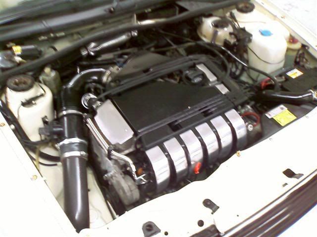

do you have a picture of the donor engine and yours?
Thanks buddy great help once again, i'll pass this onto to see if this has all been checked and if any of it is of use....i dont have a pic of the doner engine, but this is my one...well the 2.9
Can try get you a pic of the donor engine mate
