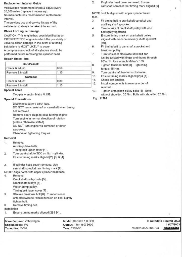

Riley 0 Posted April 7, 2008 Guys, should the two dots line up inbetween the slash on the backplate as below? Or as someone on dubforce has suggested...That they should line up with the cylinder head? a lot further up? :? Cheers,Neil. Ps:Mods, just keeping my 3 year problem thread on topic and clean, as you can imagine its been hard to follow for all involved. Quote Share this post Link to post Share on other sites
coolrado 0 Posted April 7, 2008 as far as i know the two dots on the front of the pulley should line up with the mark on the cover but there is another mark on the back of the pulley which should line up with the top of the head, i allways find it more accurate to use the one on the back of the pulley with a straight edge. Quote Share this post Link to post Share on other sites

Supercharged 2 Posted April 7, 2008 Yeah that pic is correct Riley AFAIK - I always look for the belt just starting to lift away from the pulley before the first dot... I don't know why VW made it so unclear how to line these up as with the engine in situ you can't get a straight look at it as the wing gets in the way, I think so many must be running a tooth out because of this (like the guy on Dubforce!) Quote Share this post Link to post Share on other sites
coolrado 0 Posted April 7, 2008 The other problem is some people line the rear mark up with the top of the cam cover, the rear mark must be lined up with the top of the head when the cover is removed. Quote Share this post Link to post Share on other sites
Riley 0 Posted April 7, 2008 Yeah that pic is correct Riley AFAIK - I always look for the belt just starting to lift away from the pulley before the first dot... I don't know why VW made it so unclear how to line these up as with the engine in situ you can't get a straight look at it as the wing gets in the way, I think so many must be running a tooth out because of this (like the guy on Dubforce!) Aye, its a really unclear thing with the g60's :bad-words: I think its this that has caused my god damn 3 year running problem. Ive been told you do not line the two dots up, but use the dot on the back inline with the face of the head. :? Quote Share this post Link to post Share on other sites
W3RKD 0 Posted April 7, 2008 You can use the 2 marks too in just the same way. Leval with the top edge of the head. You just look at the pulley from the other side.. Quote Share this post Link to post Share on other sites
Riley 0 Posted April 7, 2008 So the two dots don't line up with the line in the backplate like this? Quote Share this post Link to post Share on other sites
W3RKD 0 Posted April 7, 2008 So the two dots don't line up with the line in the backplate like this? No, Ive never heard of anyone using that as a referance before. Quote Share this post Link to post Share on other sites
Riley 0 Posted April 7, 2008 Its here Darren. And im sure its in the bentley manual too. http://img.photobucket.com/albums/v640/a777ovl/TimingBeltDiagram.jpg http://img.photobucket.com/albums/v640/a777ovl/TimingBeltInstructions.jpg Quote Share this post Link to post Share on other sites
Yandards 0 Posted April 7, 2008 I am guessing that the mark on the timing belt backing plate may well be a hangover from a Golf as its the same part. Quote Share this post Link to post Share on other sites
