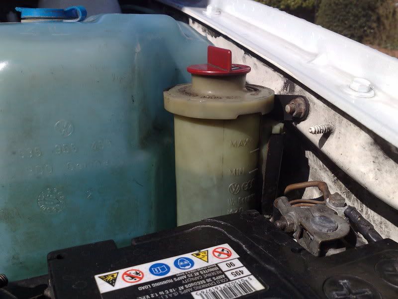

just a quick one does anyone know what the pic below is and what do i put in it

VW stuff only, just go in and ask for a litre of PAS fluid. Reason being that is a mineral blend and some other types amy well rot some seals.
Just out of interest do you have a handbook for the car?
yeah i do mate
Without wishing to sound like a get, a quick flick through there would tell you what that was and what to stick in it.
Although saying that the only stupid question is one that doesnt get asked :D
my local stealers extremely knowlegeable and helpful parts dept helped me when i first got my 16v as i was getting mixed messages re what to put in my power steering as vw have 2 methods, if the reservoir cap is Red (as mine is)then you should used ATF fluid, if Black then use power steering fluiid
