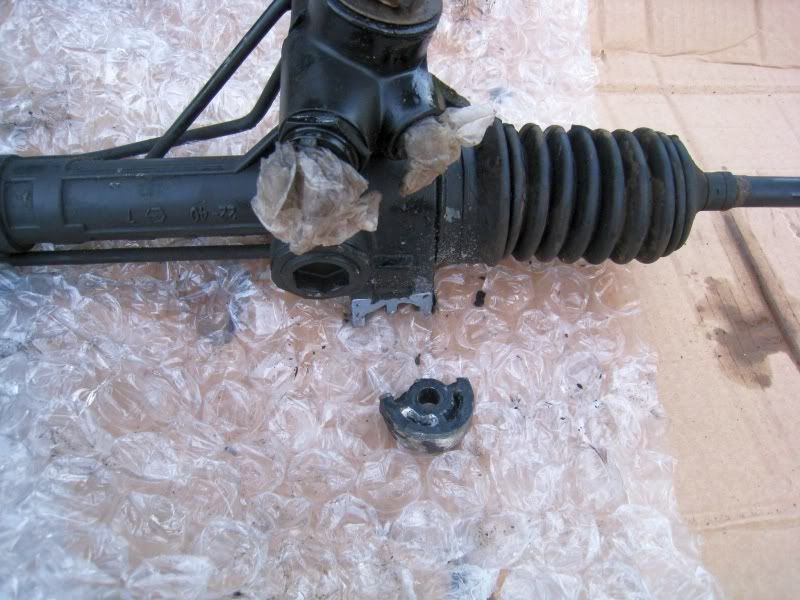

Can this steering rack be repaired?
It was damaged in transit, can the mounting be welded back on or is the rack only good for scrap now?
bin it I'd say, wouldn't want a repair breaking and the rack coming free from the rigid mount point on the subframe :shock:
can the internals be swapped to my current rack? to make one good rack out of the two? or is an new rack the only option?
its rather annoying as it took me some time to find a low mileage rack in good condition only for it to be damaged in transit.
