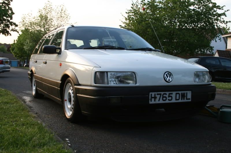

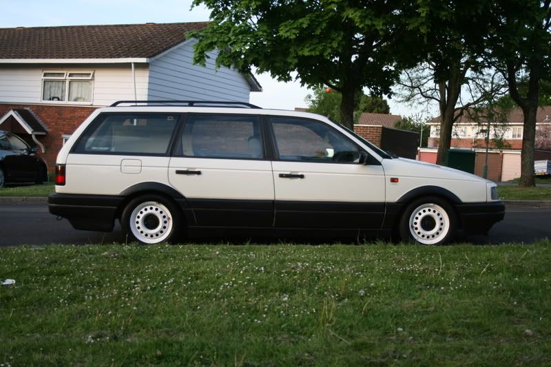

Anyhoo here's some pic's of the car incase there are some passat lovers on here and I look forward to your replies.

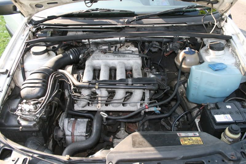

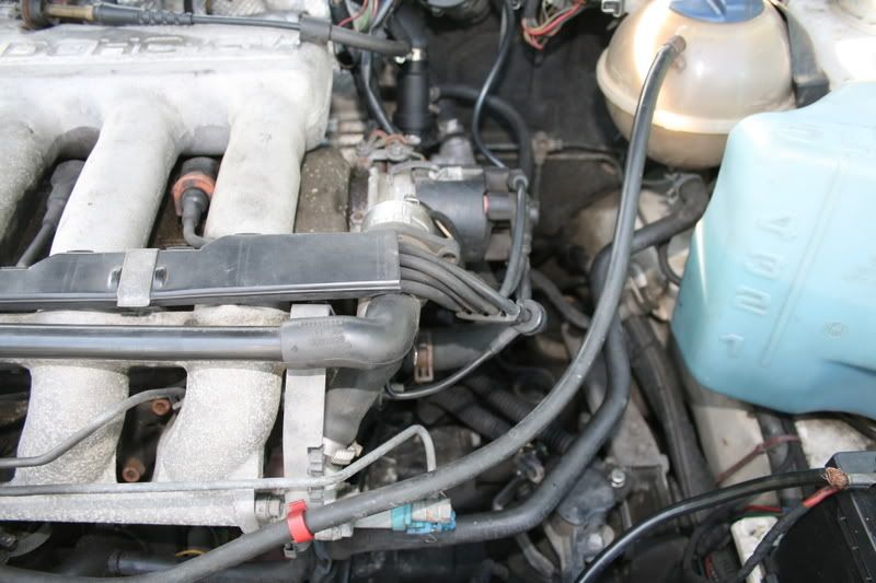

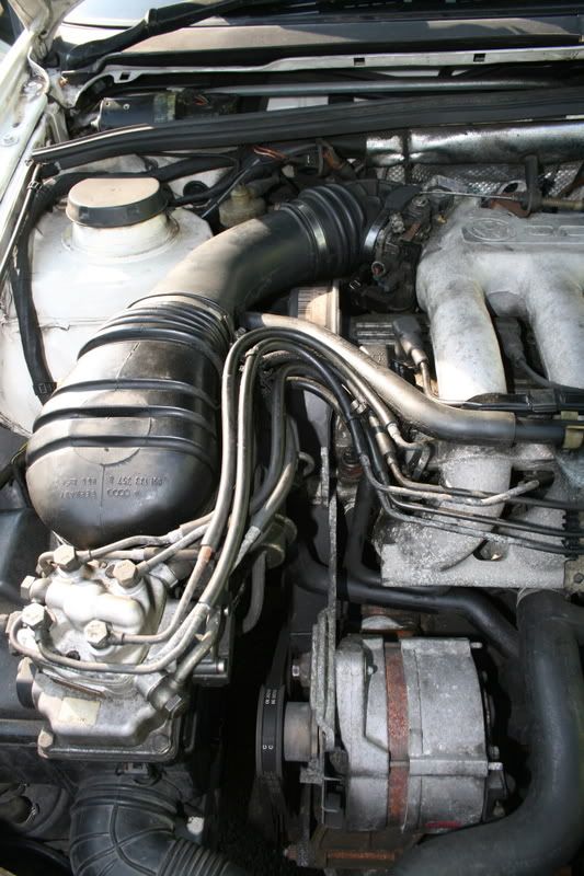

Pics of the bay:

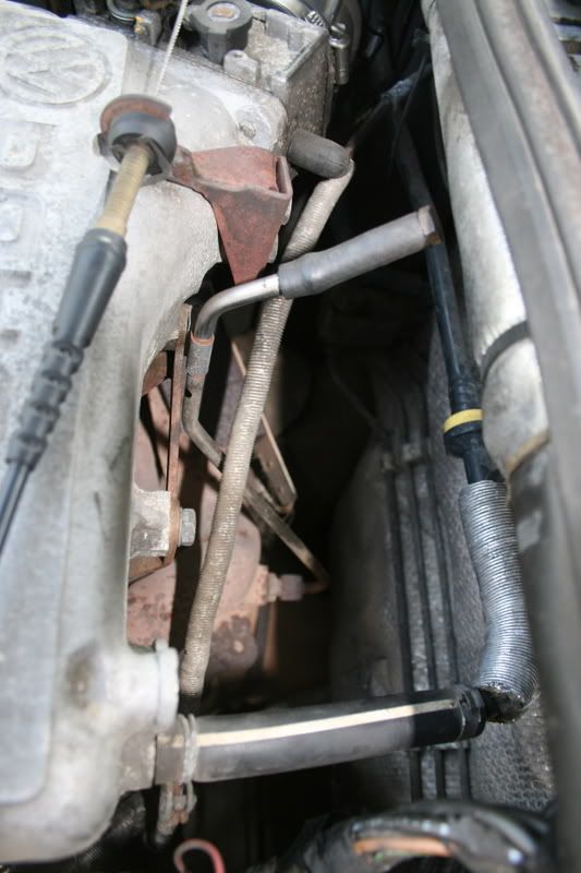

And here's a pic of where I would have thought the lambda should be but isn't! As I said though it's run fine for the month I've had it like this.
So does this all look the same as the coraddo setup?
Nick
Looks pretty similar Nick, afaik.
Do you know whether these two pipes are connected together properly? That will be a vacuum leak if not, and could lead to your hiccup-like symptoms.
hth,
Jon.
Not sure on that pipe chap, I'll have a butchers tonight and report back.
