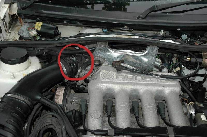

mattkh 0 Posted July 1, 2008 Hi How do I get to the control unit for idling/overrun-cut-off. Quote Share this post Link to post Share on other sites
A-J 0 Posted July 1, 2008 Its a switch at the end of the accelerator cable. Quote Share this post Link to post Share on other sites

A-J 0 Posted July 1, 2008 Pull the end of the throttle cable with the big black part. When you release this, it will move back to the original position and part of the mechanism will hit a small switch. Sorry I don't have any better pics, but it's i that area. Quote Share this post Link to post Share on other sites

krnau 0 Posted July 15, 2008 well, here there was one of my startup / idling problems. The accelerator cable didn't push this switch. I have been reading a lot about this fu**** switch, and have tested mine.... so if anyone has any questions, I will solve them if I can but here comes a question: I have read there are two switches. the idling one, and the full-charge one. where is the full-charge microswitch? I have read there, that another of my C's problems may be right there... What happens is that when I push the accelerator pedal against the floor ( :norty: ), the car accelerates much less than if I push it slowly (I mean, pushing while it is accelerating).......... and this may probably be a problem coming from the full-charge microswitch... Quote Share this post Link to post Share on other sites
Toad 0 Posted July 15, 2008 Only the 9A has 2 switches, the KR has one. Quote Share this post Link to post Share on other sites
krnau 0 Posted July 15, 2008 okay great. I found some kind of user manual for golf 2 and jetta, including kr engine. with many "how-to" test almost everyting related to k-jetronic and so on(e) (is it written with e? :D) I spent this afternoon testing all of that and I think my startup problem comes from ISV.. I have a question about cleaning it. Do I have to apply 12v to the ISV so that it opens, and then fill it with gas?? or without 12v? I did it without, and it didn't make any difference between after and before,,, Quote Share this post Link to post Share on other sites
mattkh 0 Posted July 16, 2008 okay great. I found some kind of user manual for golf 2 and jetta, including kr engine. with many "how-to" test almost everyting related to k-jetronic and so on(e) (is it written with e? :D)I spent this afternoon testing all of that and I think my startup problem comes from ISV.. Hi Well done. What manual is it ? I just immersed the non-plug end of the ISV in carb cleaner overnight. Quote Share this post Link to post Share on other sites
krnau 0 Posted July 16, 2008 I have heard you have to do it while you plug 12v in it, so that it opens the valve... I did it without 12v and dit almos nothing :nuts: Quote Share this post Link to post Share on other sites
