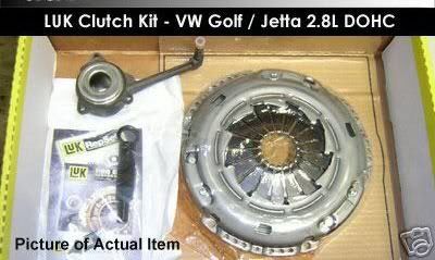

As im replacing the gearbox it makes sense to do the clutch. Seen this LUK one on ebay....
I know the LUK clutches are good as had one on the 16vt. question is what are those two items to the left? never got anything like that with the 16v. just want to check before i go shelling out on the wrong thing
Yeah thats not right at all, that slave cyl is for a much later car...
Just get a genuine VAG clutch, better quality and not much more expensive
