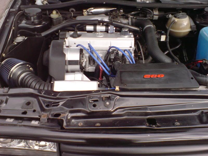

mattkh 0 Posted September 20, 2008 tried ecu and a brand new coil and the problem is still there. Hi Please put up a picture, a bird's eye view of under the bonnet. Quote Share this post Link to post Share on other sites

waynos 0 Posted September 20, 2008 pic as requested cheers for the reply rado mc will check it over again when i get the time Quote Share this post Link to post Share on other sites
boost monkey 0 Posted September 20, 2008 Sorry if this has been mentioned, but what's with the breather on the ISV? is it something to do with boost recirculation? Quote Share this post Link to post Share on other sites
waynos 0 Posted September 20, 2008 yea, before it was plumbed into the boost return pipework along with the oil breather on the cam cover Quote Share this post Link to post Share on other sites

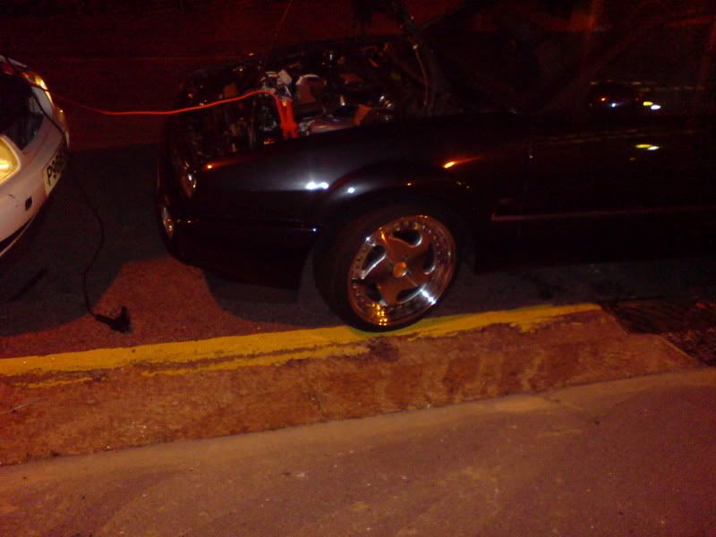

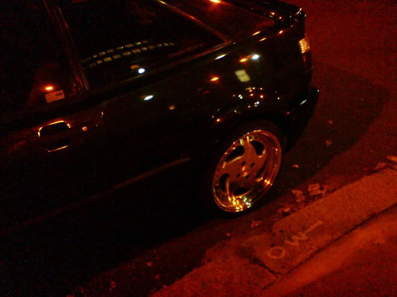

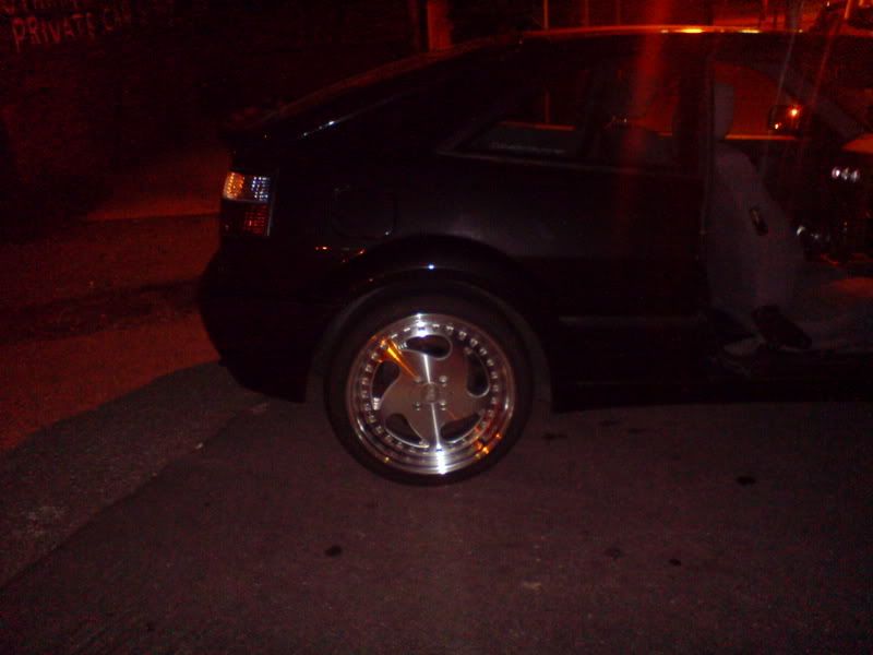

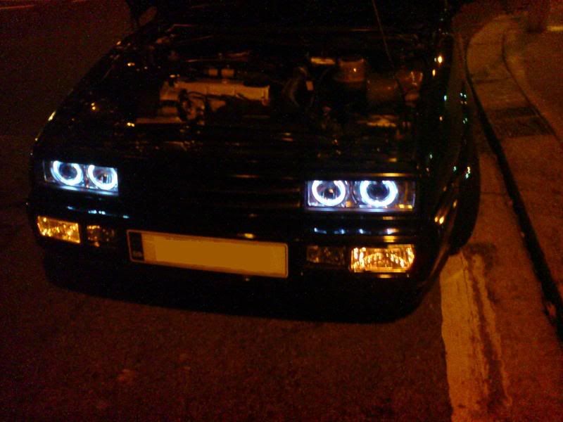

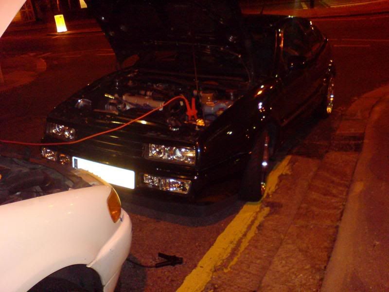

waynos 0 Posted October 13, 2008 looks like i spoke too soon. went to take the car for a spin today. Got to the second road away from my house and the misfire was back but then it dissapeared. got to my mates house which is about 5 miles away and was idling at a roundabout.idle just dropped and the car cut out. Tried to crank again but it wasnt firing. left it for a second and tried again. this time the starter wouldnt turn. We pushed it round the corner and tried to jump start it off his car. It would just crank but no start . on the third or fourth attempt it wouldnt crank at all even though it was connected to another car. the fuel pump was coming on because i could hear it and im pretty sure its getting spark so i dont know whats up. heres a few pics lol friggin car i hate it! Quote Share this post Link to post Share on other sites
