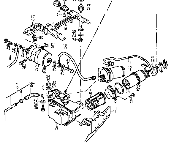

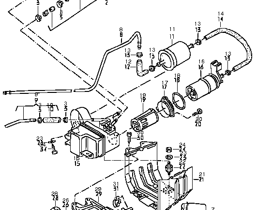

Kempy 0 Posted September 4, 2008 no. I tried to replace it and the pumps are different sizes. I was given a pump for under the car off a kr and all the fittings are different. 9A uses a bandjo bolt and the KR uses a different method. I could be wrong but I'm 99% sure. As I've faced this problem myself. You can see in the VAGCAT. Quote Share this post Link to post Share on other sites

Kempy 0 Posted September 4, 2008 This first one is a Kjet from a 9A same as mine the pump itself is nearly twice the size of the one below(can't really see from pics) also the is part 15 which is an accumulator I think. I believe this is a set up you might have which is a lot different. I'd wait for someone else to confirm or give you correct info. Best is to take a look at both pumps. 9A will be much bigger These pics are of the two different assemblies I've come across, There is also a chance the KR is the same. I thought I could help someone out, Instead of the other way round. Looks like I can't really. LOL Quote Share this post Link to post Share on other sites
boost monkey 0 Posted September 4, 2008 :lol: that's cool dude, thanks. Now you put those up they do look a lot different! Gay, I really wished those were swappable :/ Quote Share this post Link to post Share on other sites
Kempy 0 Posted September 4, 2008 still, your KR could be exactly the same, I'd check Quote Share this post Link to post Share on other sites
