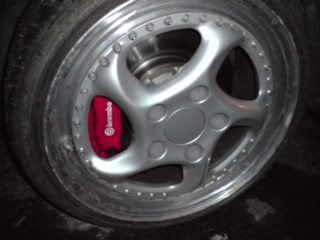

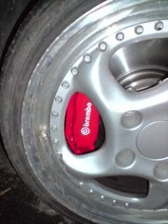

Yup, that's them! They should bolt onto the original bolt points to allow the caliper to be mounted at 90 deg to them.
Quality, that means nearly have everything now brake-wise ready to fit.
Just ordered a pair of alloy MK4 calipers for £103 delivered which was good price, and will paint them red myself. And seeing as I saved money here, ordered a pair or new caliper carriers and slider pins from VW for £127.04 delivered. So brake spec now will be as follows:
Brembo 4-pot front calipers with alloy carriers
305x28mm front brembo slotted discs
Brembo pads
MK4 alloy rear calipers
New VAG G60 rear caliper carriers
Brembo rear discs
AP Racing rear pads
Also have new bearings front and rear and new handbrakes cables to fit as well, should be a massive improvement !
Mmmmnn....................Brembo goodness and complete new rear brakes inc. caliper carriers and MK4 alloy calipers.
Think they need to do some miles though to bed in properly, as quite a lot of pedal force required / travel before they stop ! May try and remedy this by fitting the larger master cylinder from an Audi S2 though.
