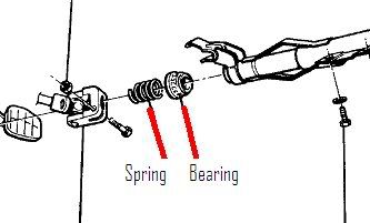

TomD 0 Posted October 15, 2008 I have exactly the same problem with mine....the adjustable bit is worn so theres quite a lot of play in the top on one setting but if you move it down a click its much better (Worked for the MOT!). I've picked up a 2nd hand corrado column with no play in it to replace it. Looking at the column I picked up it ends in the splined bit which bolts into the first UJ, but the bentley manual seems to have a picture of a spring and a bearing that need to go on the end before its bolted into the UJ. Seeing as I'm replacing the column, UJ and Subframe/all bushes etc, and have replaced the rack recently too, it makes sense to replace these too...are these available from VW still and does anyone have a part number? Also is the bearing hard to fit? (i.e. press needed?) Here's a picture... Cheers in advance! Tom :) Quote Share this post Link to post Share on other sites
TomD 0 Posted October 15, 2008 Or...is it more likely that the bearing is sitting in up in the steering column tube and I can't see it? :) Quote Share this post Link to post Share on other sites
davidwort 0 Posted October 15, 2008 I haven't actually taken mine to bits yet, but as I've said before, I think it's only the fixed column that you can replace the bottom bearing on, the adjustable column is a non-service unit, both bottom and top bearing (I think) Quote Share this post Link to post Share on other sites
TomD 0 Posted October 15, 2008 Hmm maybe I've just missed it then...does it press right into that tubing? Can probably re-use the old spring i guess. The bentley manual does give instructions to remove and reinsert it but if its Quote Share this post Link to post Share on other sites
Supercharged 2 Posted October 15, 2008 Yeah bearing just presses in (by hand) - it's only plastic cased too! Quote Share this post Link to post Share on other sites
TomD 0 Posted October 21, 2008 Cheers! Had another look and the bearing is in there - so just need the spring now! :) Then maybe the Rado will go where I point it and not where it wants too! :) Quote Share this post Link to post Share on other sites
