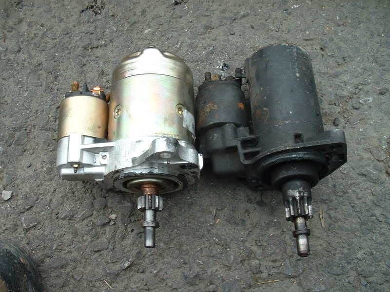

Well....i can confirm that the early and late starter motor are not the same.
I ordered a motor to fit an engine up to a 1991 and my supplier sent me a later one which doesn't fit.
I will post in here pics and details of the differences a little later tonight.
Starter on the right is the early one and starter on left is the later one.
Mounting holes are spaced differently.
Starter motor housing on later motor is bigger diameter.
Main shaft/spindle is shorter and smaller diameter on later starter.
Bendix on later starter has shorter throw.
