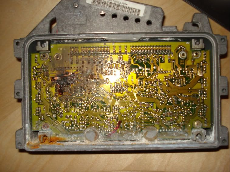

Just to close off the issue, this all fixed now. The fault was the ABS ECU. When opened there was water damage (when I got the car the passenger footwell was soaked).
If you look at the picture you can see where the circuit board has shorted out against the case.
The strange thing about this is the ABS self check worked fine (the light came on/went off) :cuckoo:
