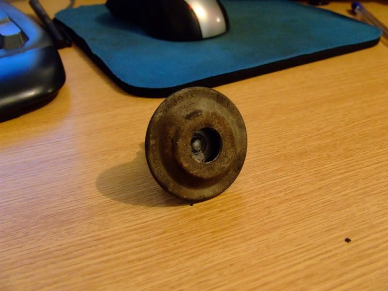

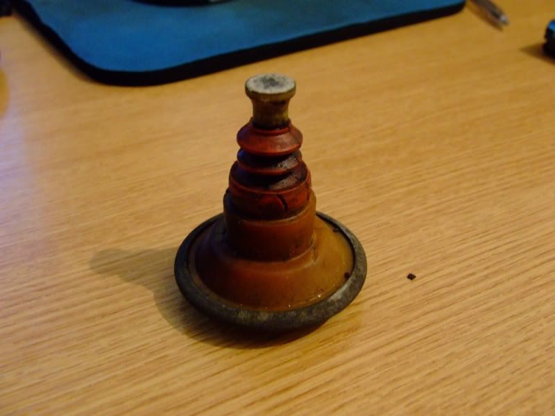

Found this lying in the subframe of my 1.8 16v.
Anyone know what it is?

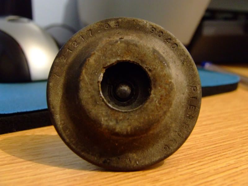

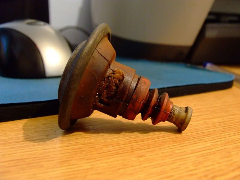

says pierburg and a number on it but ive searched the part number in vag cat and no luck so dunno what it is. heres some pics
It looks a bit like a throttle damper, basically designed to stop the butterfly snapping shut when you let go of the throttle quickly. However I'm not 100% sure!
Yup. Pretty certain it is.
100% certain it is, it sits underneath the throttle body, if you look behind there you should see the thread still intact where its snapped off
