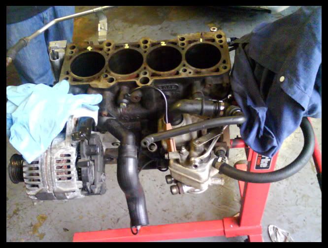

waynos 0 Posted February 9, 2009 right ive been looking at my engine today and im now baffled see pic (not my engine) now i havent got this pipe, think the guy i got it off forgot to give it to me so i need to chase him up on that. What i want to kno is what this pipe is. Is it a breather of some sort? If so where does it go? if anyone has any diagrams that would be great Quote Share this post Link to post Share on other sites
Rob_B 0 Posted February 10, 2009 it is a breather pipe. it connects to a couple of other breather pipes and leads up back into the turbo intake pipe. it doesnt need to be connected back into the system if you can put up with a little oil mist. i put a small filter on the end of mine. it is also a pain in the arse to plumb back into the turbo intake pipe when you start putting big boost pipes in, there isnt alot of room! Quote Share this post Link to post Share on other sites

waynos 0 Posted February 10, 2009 could i just put a large hose on it feeding to a catch tank? think i got another pic which ill dig out later Quote Share this post Link to post Share on other sites
Rob_B 0 Posted February 10, 2009 the thing with that hose is that it collects a few other hoses on the way to the breather outlet on the top of the head and then into the TIP. as long as you do somethin with all the outlets then you wont have a problem. i took that pipe you are showing and fed it into a small K & N filter, and did the same with the breather outlet on the rocker cover. you could feed this into a catch tank, i just find there isnt loads of room on that side of the engine bay as my TIP and my pre intercooler boost pipe run that way Quote Share this post Link to post Share on other sites

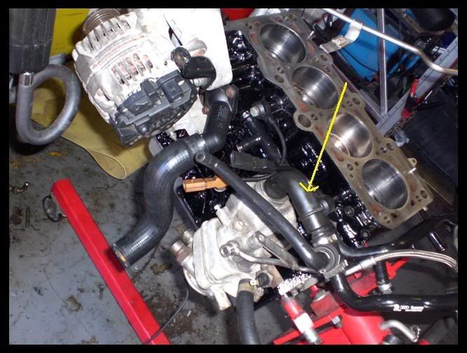

waynos 0 Posted February 10, 2009 got a few more pics been doing some more digging and found out that it uses a pcv valve between the oilfilter housing breather, the cam cover breather and the inlet manifold. You can see it better in the 2nd pic (like a t piece) I think im going to just vent mine to a catch tank , and block off the nipple at the inlet Quote Share this post Link to post Share on other sites

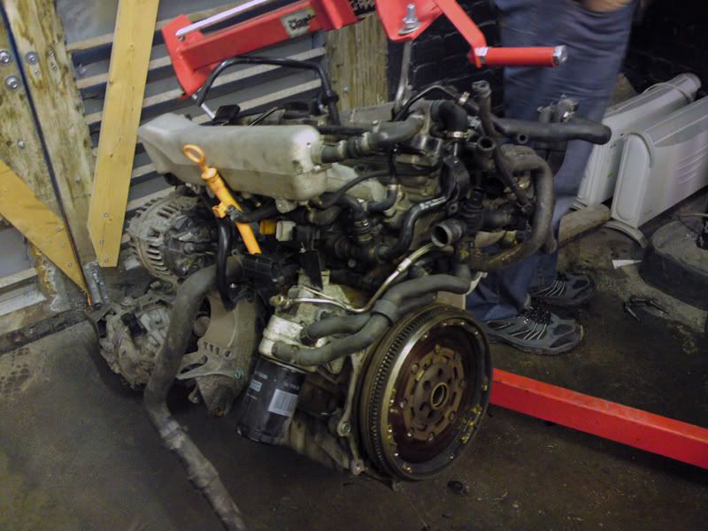

Rob_B 0 Posted February 14, 2009 the pictures arent very good as there is quite a bit of pipework and wiring going on around the breather area. i apologise for the state of my engine bay, but i have spent more than enough time under the bonnet in the last few years, and im happy to close it and drive it! :wave: Quote Share this post Link to post Share on other sites
waynos 0 Posted February 14, 2009 thats quite handy actually. I see you have two breather filters, one from the cam cover. Is the other one coming off the pipework from the top of the oil filter housing? Quote Share this post Link to post Share on other sites
dirtytorque 0 Posted February 14, 2009 the pictures arent very good as there is quite a bit of pipework and wiring going on around the breather area. i apologise for the state of my engine bay, but i have spent more than enough time under the bonnet in the last few years, and im happy to close it and drive it! :wave: cheers for taking the time to post pics. Don't apologize mate,engine bay looks good to me. I really couldn't care less about bling.Did you make that boost pipe yourself? Which 20vt engine are you running then? hows she go? Quote Share this post Link to post Share on other sites
Rob_B 0 Posted February 15, 2009 thats quite handy actually. I see you have two breather filters, one from the cam cover. Is the other one coming off the pipework from the top of the oil filter housing? yep thats right. on the original pipework for the breather system, there is a "y" piece which joined the rocker cover outlet to the pipe coming from the oil filter housing. this pipe then went into the turbo intake pipe (tip) i never put the breather hose into the tip as the pipework gets too messy and its really tight round there. i did have 1 filter coming off the y piece, but i found that this y piece collapses and was all split, so i ditched it and just put another filter on the rocker cover Quote Share this post Link to post Share on other sites
