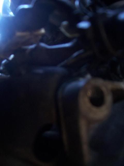

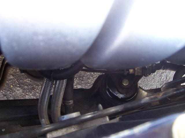

GaVR6in 0 Posted March 2, 2009 Here are some pics the first is from the top showing the front engine mount, The second is showing the brackett from underneath with the bolt missing I know they are not much help but does the gearbox need to come out to replace these bolts and is this the same as a golf. Quote Share this post Link to post Share on other sites
ADZ_VR6 0 Posted March 2, 2009 If thats the front engine mount bracket you should be able to just support the engine and unbolt it no need to remove box. someone had welded mine where the bracket had snapped so i had to strip rad and al sorts off the front end just to get a grinder in, but the box stayed on mate. Hope that helps u pal Quote Share this post Link to post Share on other sites
GaVR6in 0 Posted March 2, 2009 Yer I looked at it and it looks like I can just replace the bolts myself, thanks for all the replys lads. Quote Share this post Link to post Share on other sites
