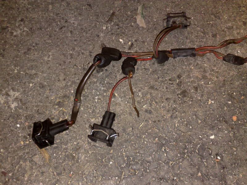

rixy 0 Posted March 19, 2009 here r the results of an hours playing :-) think i've found the problem, and u was exactly right "supercharged" changed it for a mk2 digi loom that was in full working order, and away she goes - 4 cylinders again :-) cheers m8 Quote Share this post Link to post Share on other sites
Rob_B 0 Posted March 21, 2009 now, im no electrician, but i can see there is a problem with that loom....there are only 3 plugs?!?! :epicfail: Quote Share this post Link to post Share on other sites
Supercharged 2 Posted March 21, 2009 LOL - Yeah that's fairly dangerous - especially with that small fuel pipe at the end of the rail - I'd check and replace that too! Quote Share this post Link to post Share on other sites
rixy 0 Posted March 21, 2009 i have checked and replaced the pipe already :-) :clap: Quote Share this post Link to post Share on other sites
