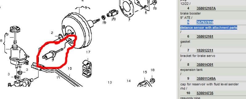

-Neil- 0 Posted March 25, 2009 ive been to GSF and they dont stock it, i take it its a VW dealer part only? how much is it and does anyone have a part number please, i cant find it on VAGcat.com! Quote Share this post Link to post Share on other sites
davebirl 0 Posted March 26, 2009 should be able to get one from a breakers. I replaced it on my last VR6 and the fault never returned. Quote Share this post Link to post Share on other sites
-Neil- 0 Posted March 26, 2009 should be able to get one from a breakers. I replaced it on my last VR6 and the fault never returned. haha, trying to find a corrado in a breakers, might aswell start looking for that neddle in the haystack! Quote Share this post Link to post Share on other sites
Supercharged 2 Posted March 26, 2009 Same part as fitted to a MK3 Golf but I'd just buy new - only £50 ish Quote Share this post Link to post Share on other sites
-Neil- 0 Posted March 27, 2009 i went to VW today and they couldnt find it on vagcat, but he went in back and said it can either be one of two things, 1H0612151C (cant find that # on vagcat) at £77.96 or 358614041A at £19.15 Can ANYONE help please!!! Quote Share this post Link to post Share on other sites
-Neil- 0 Posted March 27, 2009 is this it? Partnumber------ Title --------Price 357927810 ----SENSOR ----52.5 Euro Quote Share this post Link to post Share on other sites
-Neil- 0 Posted March 29, 2009 please can anyone help. someone must know where this part is on vagcat.com or have a reciept witgh a aprt number, please help me! Quote Share this post Link to post Share on other sites
KipVR 1 Posted March 29, 2009 That's the part you've highlighted mate :thumb right: Quote Share this post Link to post Share on other sites
-Neil- 0 Posted March 29, 2009 thank you so much! Quote Share this post Link to post Share on other sites
