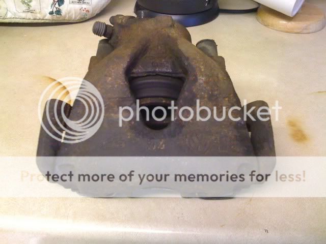

Hi i'm wondering if anyone can help me, I purchased a set of MK3 GTi calipers to go on my 16v corrado but i'm not sure if they will fit! I've tried to find a part number on them but have drawn a blank. From a bit of research I have discovered that the Mk3s did two types of calipers. These were 280mm on the early models and 288mm on later models and I need to know how to tell the difference.

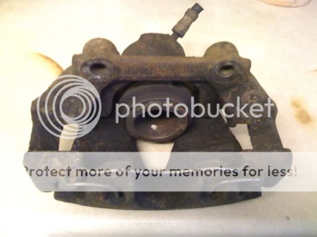

Here is a rubbish pic lol!
288's
the wire and the 'ATE' casting identify them
you need the 280's which look basically the same as the 256's

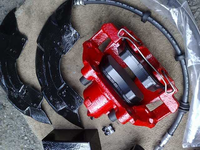

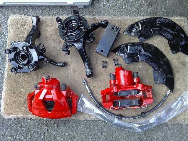

hi mate, ive just done this convo yday ......mk3 calipers do fit and i used 280mm disks......you need mk3 gti brakes hoses which screw in.
heres some pics 8)
enjoy, bob

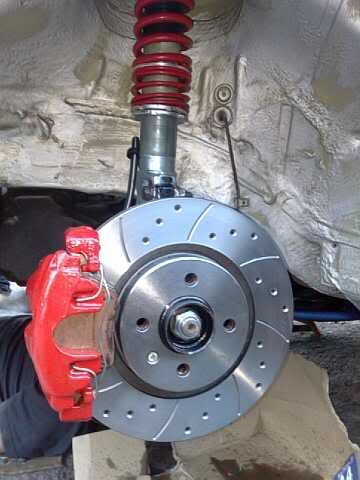

That looks awesome mate, my only worry is that do the pads hang over the edge of the disc meaning that they will wear with a lip on them. If they don't then I will use these calipers for my brake upgrade! Cheers mate
no, prefect fit.......
mk gti calipers
G60 drilled/groved/vented discs
mk 3 gti hoses
mk3 golf pads
alot of blood, sweat and power coating....... aint tested them yet but they clear fine when spinned and bleed up fine too. I also used mk3 VR6 rear calipers.
