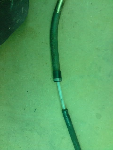

heres the prob
the hole in the black plastic bit is smaller then the cable.(i cant pull it off either) can i heat that up so it expands or did u mean just cut/melt the end of the old cable off?
i dont trust myself with a blowtorch lol
