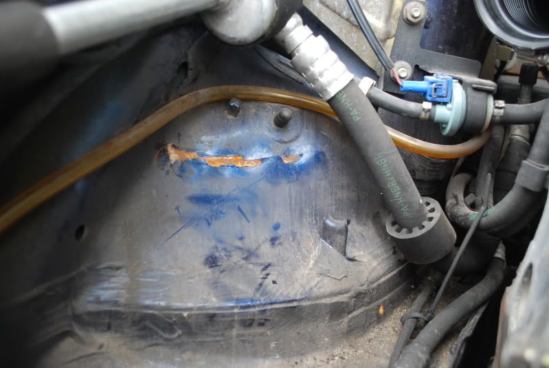

first , when i got the airbox off, i found this:
its been cut and welded.
Should i just clean/paint it to prevent more rust?

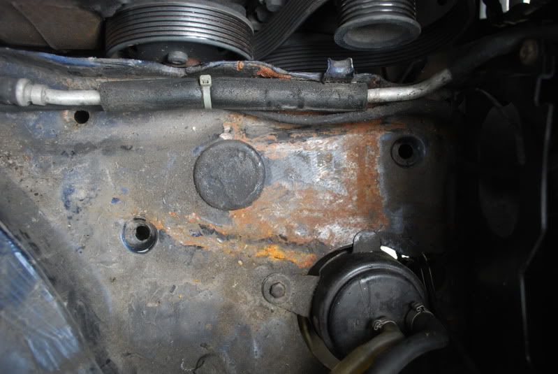

and now what really bothers me, the seals are like cracked and the edge is like 1-3mm opened.how bad is this, whats can i do about this?

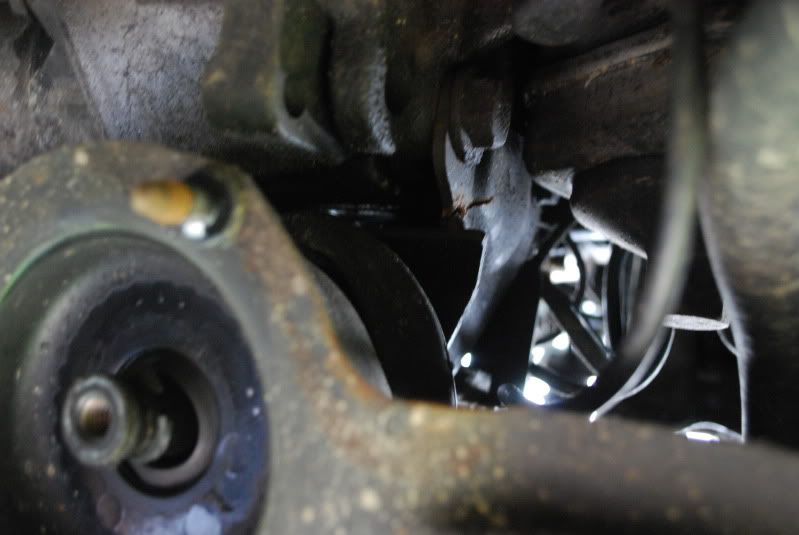

and the third thing is that the front engine mount (steel part that holds the engine on the bush ) is cracked on one side, does anyone know the part nr ?

Hmm,that motor of your looks as if at some point its had a prang...
I reckon you should just get some Sikaflex sealant and go over the cracked sealant,not a lot
else you can do really.
As for the mount,i'm not sure if the vr's front bracket is different than the G60 jobbie,if they are
the same i've got a few spare.
Cheers.
Hello, I wouldn't say the paint is too bad considering the age of the car but obviously needs attention to stop it getting worse...
You need to change that bracket though and yes, it is VR6 specific.
