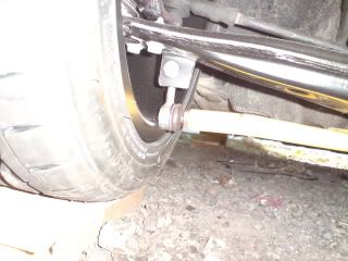

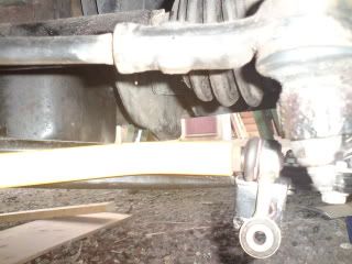

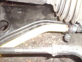

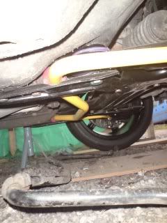

joinerboy 0 Posted August 7, 2009 im sorry for bringing more problems to the forum but im stuck. i have looked for answers but cant find them which way is the front arb fitted on a vr? this is how its currently fitted iv taken pics to show the problems: sorry for the quality im 99% sure that the ARB is up the right way but does it attach above or below the wishbone? if its below then it dangerously close to the wheel when i try to fit it above it rubs against the wishbone help please. what am i doing wrong? i cant see how turning the arb over will change anything. the only things i can think off are that the arb is too long(although its for a vr), or the drop links are to long. i got them from gsf and im sure they were for the vr6 anyone had similar problems? or can anyone tell me whats wrong? thanks Quote Share this post Link to post Share on other sites
nemesis360 0 Posted August 7, 2009 The ARB is mounted above the wishbone, if the bar looks like its too long to fit then it is probably upside down. Hope that helps Quote Share this post Link to post Share on other sites
Kevin Bacon 5 Posted August 7, 2009 I can't see the pics but as said already, the front ARB fits about the WBs, I.e. the drop links point down. The front ARB will fit either way round, but if it's 'upside down' the middle part of the ARB will foul the exhaust downpipes when you lower it back on the ground. Quote Share this post Link to post Share on other sites
joinerboy 0 Posted August 7, 2009 ok so the arb is the right way up because it clears the exhaust. so thats not the problem can anyone uploads pics of what there front ARB/drop links look like so i can compare the setup to mine? Quote Share this post Link to post Share on other sites

Jim Bowen 1 Posted August 7, 2009 am sure mine doesn't stick down like that in the middle Quote Share this post Link to post Share on other sites
joinerboy 0 Posted August 8, 2009 can i have a definite yes or no as to whether the arb is fitted correctly. i dont want to take it off(which will be a nightmare) to find out i didnt need to change it Quote Share this post Link to post Share on other sites
Jim Bowen 1 Posted August 8, 2009 i'll go out to mine after dinner and get a photo, i could well be wrong when i said that above :nuts: Quote Share this post Link to post Share on other sites
joinerboy 0 Posted August 8, 2009 i appreciate that thanks. last thing i want is to drop the subframe for no reason :lol: Quote Share this post Link to post Share on other sites
Jim Bowen 1 Posted August 8, 2009 didn't get a photo but its the same way up as yours, so its correct Quote Share this post Link to post Share on other sites
joinerboy 0 Posted August 10, 2009 problem solved. i dropped the car with the ARB un-attached then it cleared the wishbone. so i then fitted it. it was touching at first because the angel of the wishbone. thanks for your help though Quote Share this post Link to post Share on other sites
