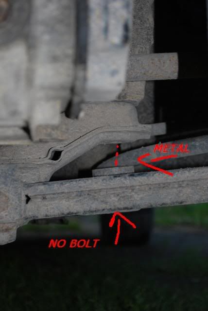

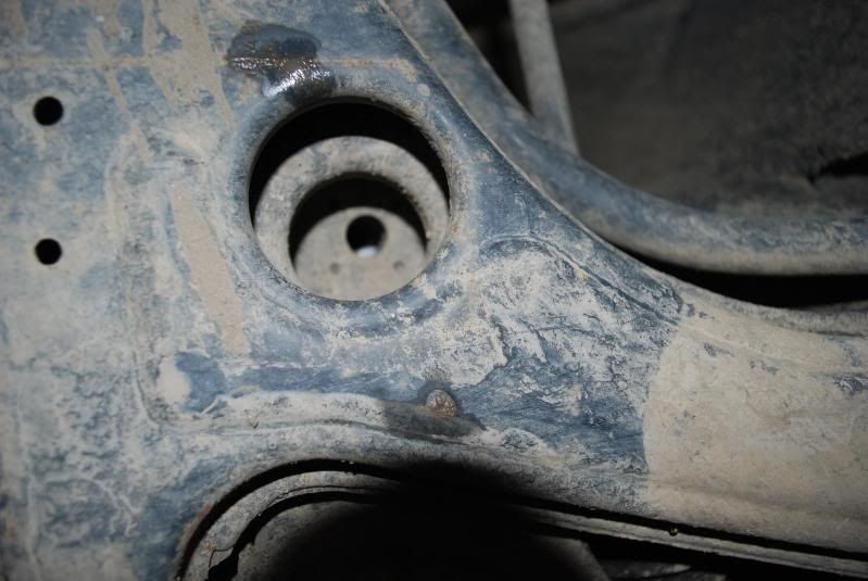

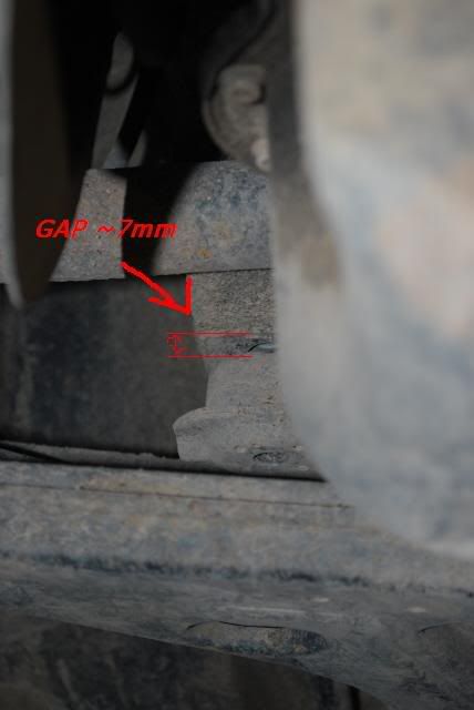

so i bought this 94' corrado vr6 a few months ago , had it MOT'd the same day, everything was ok. today i lifted the car up alittle and noticed that the subframe had 2 bolts missing ( the threaded part in there is wobbling, like a loose piece of metal ) , also i believe there should be some bushes.

both sides have no bolts or bushes.

Sheeeet!! - Yeah there should be a bolt through that hole holding the subframe up but you're not missing a bush - the hole is just there in the control arm so you can get to that bolt to drop the lot.
Must have come loose I guess and dropped out :shock:
Just re-read it - both sides missing!
Must have been a result of a subframe or steering rack change by a cowboy garage... I'd try and find out what was done do you can check everything else out too!
