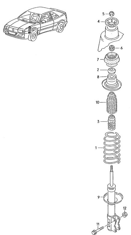

Mawrick 0 Posted December 3, 2009 hmmm, AFAIK this is the way they go on: but I'm not convinced that the nut I have from germanautoparts is the one that's supposed to be there, as I was under the impression the bearing should be able to rotate freely inside the rubber bushing - and the nut doesn't go "thru" the rubber. Anyone have pics of an OEM - from VW nut that's sits in this area?. Quote Share this post Link to post Share on other sites
Mawrick 0 Posted December 3, 2009 Or is this the way to do it - this is how the vw part catalouge lines it up: Quote Share this post Link to post Share on other sites
Mawrick 0 Posted December 3, 2009 And to answer my own Q it seem that the last pic is the right one - and the nut should be alright.......... Quote Share this post Link to post Share on other sites
Mawrick 0 Posted December 3, 2009 hmm, getting a bit confused now - got some input from someone else telling me this is the original nut: and should use that instead.....not holding the rubber mount.... Quote Share this post Link to post Share on other sites

Critical_Mass 10 Posted December 4, 2009 Goes 7, 5, 3 (holds the bearing), 4, 6, 2 then 1 The nut should go through the rubber top mount and holds the bearing, just dont tighten it so much that it holds the bearing too much. Quote Share this post Link to post Share on other sites
Mawrick 0 Posted December 5, 2009 Will do ;) I'l loose the germanautoparts nut and use another one though...;) Quote Share this post Link to post Share on other sites
Critical_Mass 10 Posted December 5, 2009 ooops edited the above post. Missed out 6..... dont lose faith. Quote Share this post Link to post Share on other sites
Mawrick 0 Posted December 5, 2009 hmmm, ok, so nr 6 should be there also - are u sure???..... I thought it was only for OEM.... Quote Share this post Link to post Share on other sites
