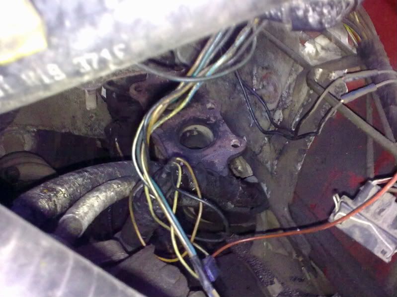

looks like i can sneak the manifold around the side of the engine and hopefully the 4 branch will go in that way too.

well i got the the old downpipe off (grinder on the twin pipes, thank you) got the exhaust manifold off too. which was a barrel of laughs.
am i best to use the original studs or put bolts in for the stainless?
and yeah still not sure about getting it in yet....looks tight for sneaking it down the side of the engine but if not i think i might take the drive shaft off looks like it will go, and i discovered it had nearly fell off whilst looking at it today, nice :scratch: .

bugger mine doesnt seem to fit from under or round the side, only had a quick go as light was fading.
think its gunna be drive shaft out the way to get it in....but need to look at drive shaft for damage anyway as it nearly fell off, could have cost a few quid!!
