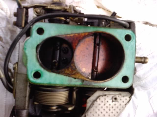

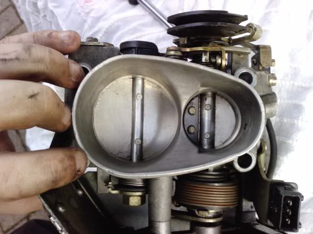

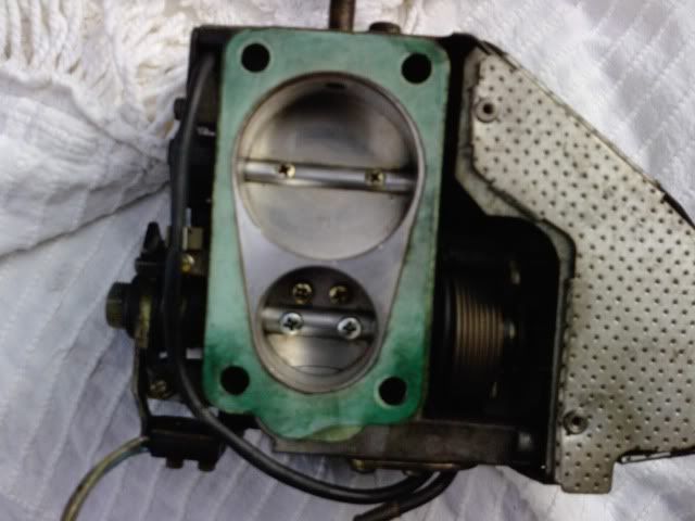

Swompy 0 Posted October 10, 2009 Cleaned mine today, was rather dirty one side but clean the other. Had a bit of trouble undoing the 4 bolts they did start to round off but a few light taps with a hammer on the alan key sorted that out :D Gave it a good old clean and put it all back on then went for a spin It hasnt curred the problem but the car feels more urgent when i put my foot down, also when the revs do decide to drop down when i engage the cluth it happens alot quicker. The how to guide was very helpfull, so much easyer when you have pics to help you out. Especialy when you know hardly anything about the engine bay :D Have a few pics I will upload later when i get the time :salute: Quote Share this post Link to post Share on other sites

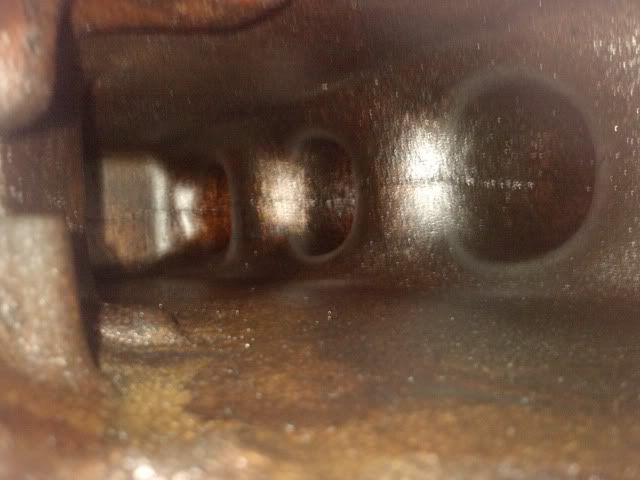

Swompy 0 Posted October 11, 2009 Here are the pics as promised to start with the inside of the manifold and after a good clean also my little helper hard at work Quote Share this post Link to post Share on other sites

Swompy 0 Posted October 13, 2009 HAHA no worrys, I dont think it is the switch or cable as Dave and Graham both looked at that when I payed the a visit a few weeks ago and they said they are good. Only thing I can think of is either the cold start valve has a intamitent problem, or its the cold start sensor thingy :confused4: I know I couldnt belive how dirty it was and the car has only covered 85K miles. I'm not to fused about the inlet manifold as I have a nice new and clean one to go on soon 8) Quote Share this post Link to post Share on other sites
