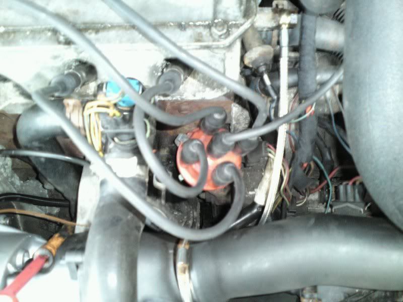

Rinse 0 Posted October 29, 2009 Right, got the charger rebuilt. Got it all back on the car today, primed the charger then tried starting it, ticked over with a very loud backfire then it just started idling very very rough, throttle was doing barely anything and it was backfiring like mad!! Only thing i can think of that i've changed is I might have mixed up one or two ignition leads on the dizzy, I've just pulled up a photo of a g60 and put them all onto the same ones, tried starting it and it won't even tick over. Please help, i've got to drive to Aberdeen tonight! Quote Share this post Link to post Share on other sites

dirtytorque 0 Posted October 29, 2009 Sound like your firing order is out. it's 1-3-4-2.The dizzy rotor turns clockwise. #1 is at 13:00 on the dizzy I think. Quote Share this post Link to post Share on other sites
Rinse 0 Posted October 29, 2009 Sound like your firing order is out. it's 1-3-4-2.The dizzy rotor turns clockwise. #1 is at 13:00 on the dizzy I think. Thats what I put them at, but i've just realised that the dizzy isn't in the same position as the photo I used to place em. This is the photo I took the order from. This is how mine is now. Quote Share this post Link to post Share on other sites
weetos 0 Posted October 29, 2009 Sound like your firing order is out. it's 1-3-4-2.The dizzy rotor turns clockwise. #1 is at 13:00 on the dizzy I think. Thats what I put them at, but i've just realised that the dizzy isn't in the same position as the photo I used to place em. This is the photo I took the order from. This is how mine is now. there should be a little line on lip of the dizzy under the cap this should be No.1 work clockwise from there Quote Share this post Link to post Share on other sites
Rinse 0 Posted October 29, 2009 yeah I just took it apart and seen the notch. Put em all back in and we're in business! :clap: All sorted, knockings gone too! Need to change the ECU vaccum hose though, its seen better days! Cheers to everyone for thier help!! Quote Share this post Link to post Share on other sites
