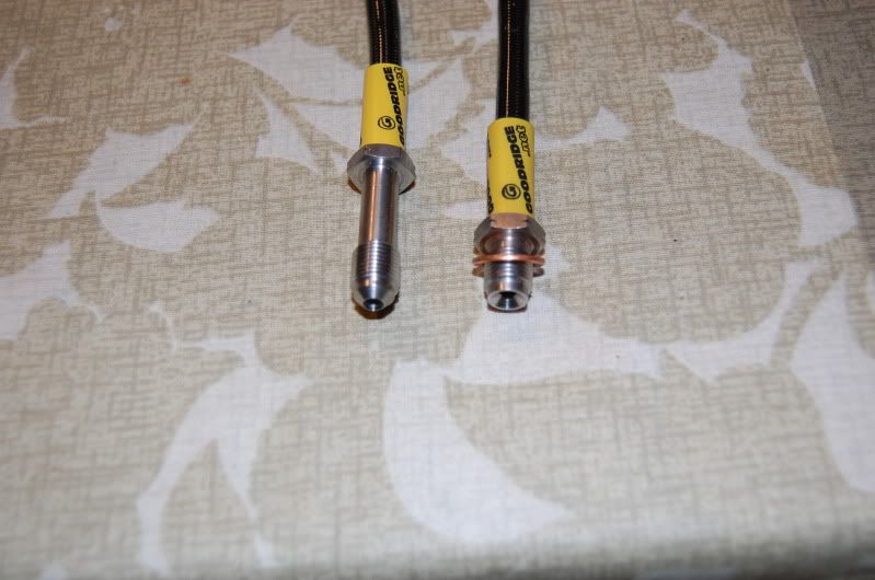

Mawrick 0 Posted March 30, 2010 I bought a goodrich "braided" line brake hose kit from deamon-tweaks late last year. Stated a 95 VR6 - now that we try to fit the cables to the rear caliper it seem to have a wrong type of "cone", and it seem to "bottom" before it actually seals. Anyone else used these kits - and know what might be wrong.... just sendt them a mail, hopefully they can sort this out. If I end up going with OEM - could I still use the braided on front and on the ones that goes to the axel ? (ie OEM on rear and braided on rest) ? Quote Share this post Link to post Share on other sites

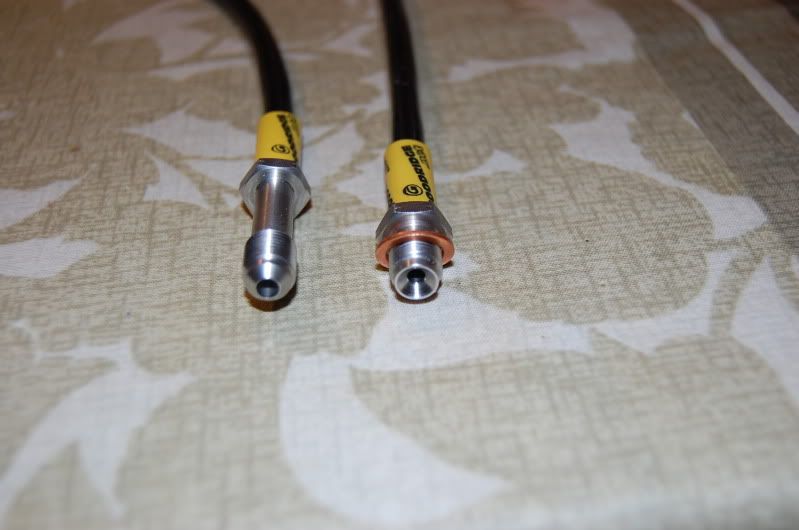

Mawrick 0 Posted April 12, 2010 The one I got look like this: The one on the left is supposed to go in the rear caliper - the other one is for the front caliper. I would presume and would like the tip to be the same on the rear as the front - without the bras shims thingy (it should be like that "cone" tip to get it "thight"). Quote Share this post Link to post Share on other sites

craigowl 0 Posted April 13, 2010 Here is copy of my garage mechanics note to Goodridge supplier. Hope this helps. God! - it was 6 years ago! Quote Share this post Link to post Share on other sites
Mawrick 0 Posted April 13, 2010 great! - seem's to me that's the same trouble there is with mine :) Tere should not be a copper washer - and also the "end" should be same as the front one........ I presume it would be ok for me to forward this to the supplier I bought it from ?. Quote Share this post Link to post Share on other sites

Supercharged 2 Posted April 14, 2010 Yeah they don't look right from the pics - don't think any VW rear caliper uses a connection with washers like that! Have a look at the pics on this page - this is what the hoses should look like http://www.vwspares.co.uk/corrado_brakes.php Quote Share this post Link to post Share on other sites
