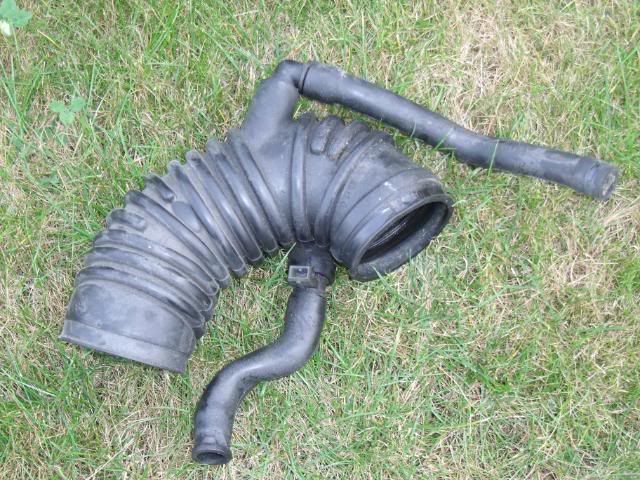

A5 VRX 0 Posted April 5, 2010 Alright people, picked up a standard airbox for the VR6 last weekend, i've tried to fit it but the top will not line up with the bottom (fits together fine off the car) looks like the MAF is too big or the plastic elbow that fits onto the back of that, could this be possible? Top of the airbox is about an inch out forwards from the bottom? Any help would be much appriciated thanks Adam Quote Share this post Link to post Share on other sites

A5 VRX 0 Posted April 5, 2010 http://i53.photobucket.com/albums/g74/blackvalver/S4020351.jpg http://i53.photobucket.com/albums/g74/blackvalver/S4020348.jpg http://i53.photobucket.com/albums/g74/blackvalver/S4020350.jpg http://i53.photobucket.com/albums/g74/blackvalver/S4020349.jpg Quote Share this post Link to post Share on other sites
KADVR6 0 Posted April 5, 2010 on the third picture down it looks like you have some non standard black rubber piping inserted into the elbow?? making the MAF pointing to far forward?? Quote Share this post Link to post Share on other sites
A5 VRX 0 Posted April 5, 2010 Yeah thats the first thing i checked, but when i checked theres no join, as though its all one Quote Share this post Link to post Share on other sites
tandino 0 Posted April 5, 2010 That looks like an early MAF with the later plastic versus rubber MAF air pipe Quote Share this post Link to post Share on other sites
A5 VRX 0 Posted April 6, 2010 That looks like an early MAF with the later plastic versus rubber MAF air pipe Seem to be getting somewhere now! What do i need then (or not) to fit this airbox? Cheers bud AJ Quote Share this post Link to post Share on other sites
tandino 0 Posted April 6, 2010 That looks like an early MAF with the later plastic versus rubber MAF air pipe Seem to be getting somewhere now! What do i need then (or not) to fit this airbox? Cheers bud AJ You need the earlier rubber concertinered hose from MAF to throttle body rather than the later 6 pin OBD1 plastic hose you have now... Quote Share this post Link to post Share on other sites
A5 VRX 0 Posted April 6, 2010 Cheers, thanks for the info. Thought there might be a difference between the hoses in the first place! Ta mate Adam Quote Share this post Link to post Share on other sites
quicky1980 0 Posted April 6, 2010 Cheers, thanks for the info. Thought there might be a difference between the hoses in the first place! Ta mate Adam I have two of the items you need , £20 inc delivery (£25 including the short pipes attached) Quote Share this post Link to post Share on other sites
A5 VRX 0 Posted April 18, 2010 All sorted now, it was that part i needed above, someone kindly gave me a spare Cheers anyway AJ Quote Share this post Link to post Share on other sites
