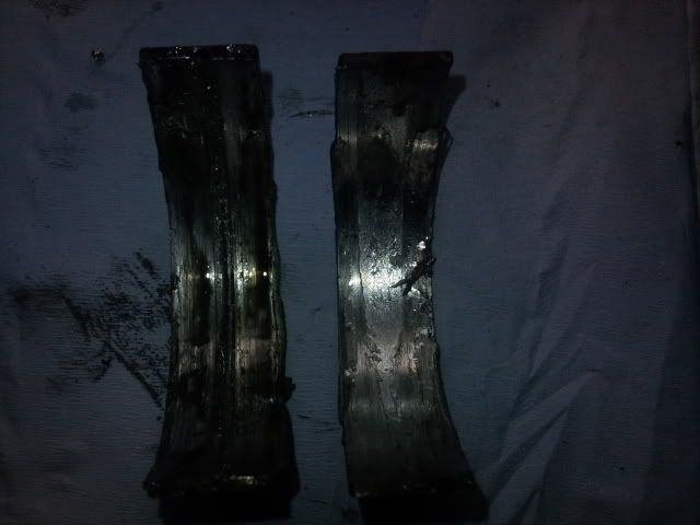

As they say a picture is worth a thousand words, so here's what I found

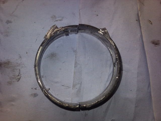

The shell of the second crankshaft bearing was completely scored up. As soon as i took it out the engine would turn over lovely by hand.
Now my question, as a noob, is what would cause this?
The previous owner told me the oild light/buzzer came on, so he took it to a garage where whilst investigating it, the engine went tight. He told me the car was never driven since this point. And to be honest I believe him, as the crankshaft looks to be in good nick. I don't think it has scored it.
Secondly, to fix this, is itjust a case of new shells and away we go?

Are they all trashed or just #2? It looks like it has lost oil pressure for whatever reason, and that journal has overheated and picked up the bearing shells.
I would look carefully at the cams and the other bearings and see if there is any more damage, as its likely whatever has caused the loss of oil pressure has had some other effects as well. Check the oil pump, oil cooler, etc.
It could be that it spun that bearing first and that was the cause of the loss of oil pressure. I have heard of VR6s spinning bearings, but I don't know why they would do that in the first place without some other cause.

yep looks like oil starvation. The crank would need serious amount of punishment to get scored, the bearing shells are there for just that reaspn, to be the 'wear point'. I would change them, making sure that the new shells are properly fitted and oiled. When you do fit them in, make sure you line them up properly. Oil them nicely before fitting. I was advised that grease is not a good idea here.
There is an oil feed groove in the shell so gently press this into the oil feeder point. Also make sure that the shells are central axially. It will be obvious, as you've already taken it apart. Bolts can also be reused, unless they've already been off a few times and have stretched. You seem pretty clued up so i dont think you'll have any issues. :wink:

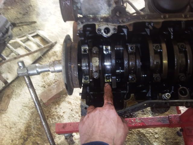

i started by taking the conrod bearings out, and they all looked ok, so i then moved onto the mains, and got as far as number 2 which was fooked. havent's taken the rest off. i think i will though because i'll probably take the crank out to give it a polish on the one that failed. is it possible to remove the crank without disturbing the upper chains? don't really want to lose all the timing.
can someone tell me what a journal is, is it the groove in the shell which lets the oil pass, or is it the hole in the crank? also where does the oil come from in that hole? i can't see anywhere that oil is pumped into the inside of the crank?
it would seem that oil has been starved to that shell, but if the oil pump was nackered, wouldn't the all be trashed?
is there any way of testing an oil pump?

oil starvation would normally result in the shells becoming very hot and therefore ending up discolored and blue. It is possible that you have a case of oil starvation and you just caught it in the very early stages. The oil light coming on would support this, but then it can be a bit of a chicken and egg situation, 'cause once the crank seizes and the tolerances between the crank and bearings become knackered you are likely to get oil pressure problems.
I don't know the exact ins and outs of this engine design, but I would have thought that if one of the mains were to go from oil starvation it would be one of the end ones (main 1 or main 7) as one of these would likely to be fed last.
The cap side shell in particular shows some edge loading. If it were a new engine or a newly rebuilt engine I might suspect an alignment issue.
When you strip the other shells you should learn more. If they are all on the verge of breaking down then it probably was straight oil starvation.
I was quite surprised to hear the big end shells were ok, I would have thought one at least would be fed by that main journal and would have picked up all of the debris from the seizure.

Tracking down a failure on a single bearing is tricky, especially if all the rod bearings are still good. It could simply be that the oil pressure was low and that bearing got picked up and spun around the crank, but the others just managed to hang in until it stopped. I'd have a good look at the oil pump to make sure that is still intact and within tolerances, and also blow all the oil galleries out with an air line to make sure there aren't any blockages anywhere.

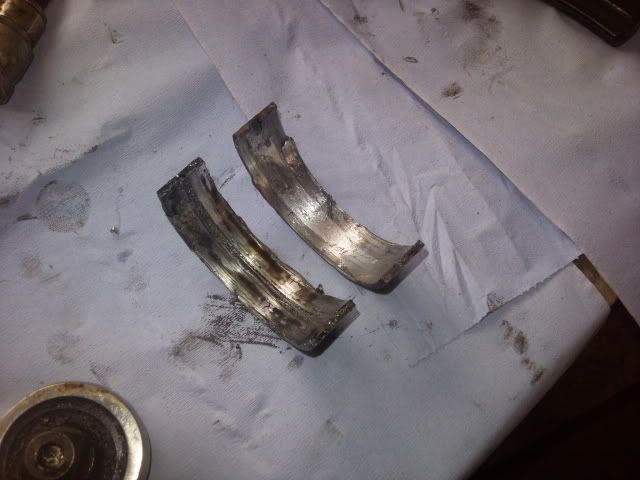

managed to get another 1/2 hour to look at it today. took the rest of the main bearings off and found the following
#1 just beginning to fail
#2 (pictured) the worse shell
#3 almost as bad as #2
#4 not quite as bad as #3
#5 again, just on the verge of failing
#6 & #7 perfect condition, look brand new!
so this is more pointing towards a loss in oil pressure, as 5 out of the 7 shells have started to break up. with #'s 2,3 and 4 being the starting point
