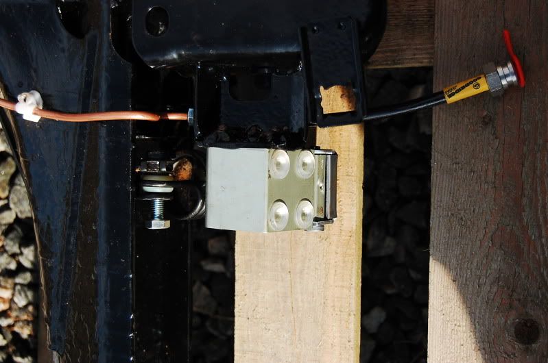

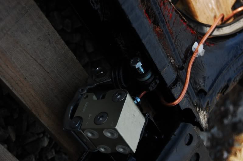

My brake valve (VR6 version):
DSC_1507.jpg?t=1273876020
DSC_1509.jpg?t=1273876022
