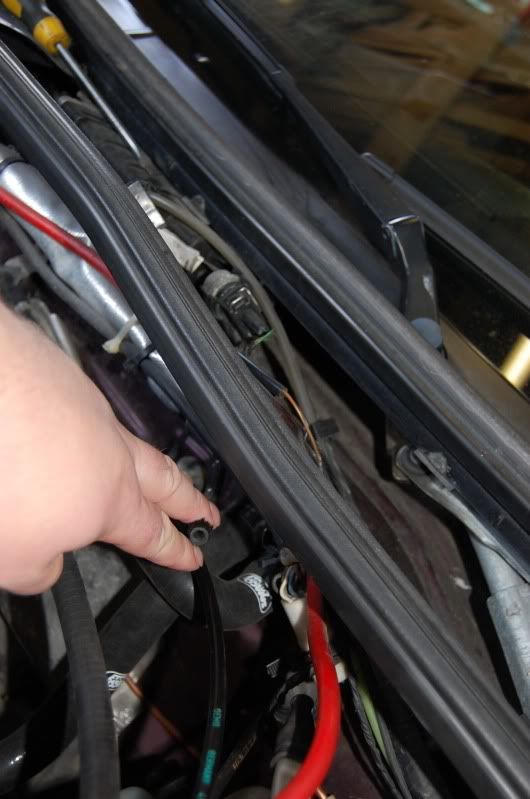

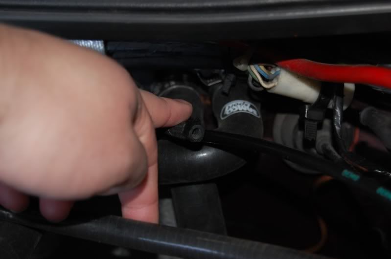

here are soem better pics of the one hose I'm talking about:
DSC_1581.jpg?t=1275392202
DSC_1580.jpg?t=1275392204

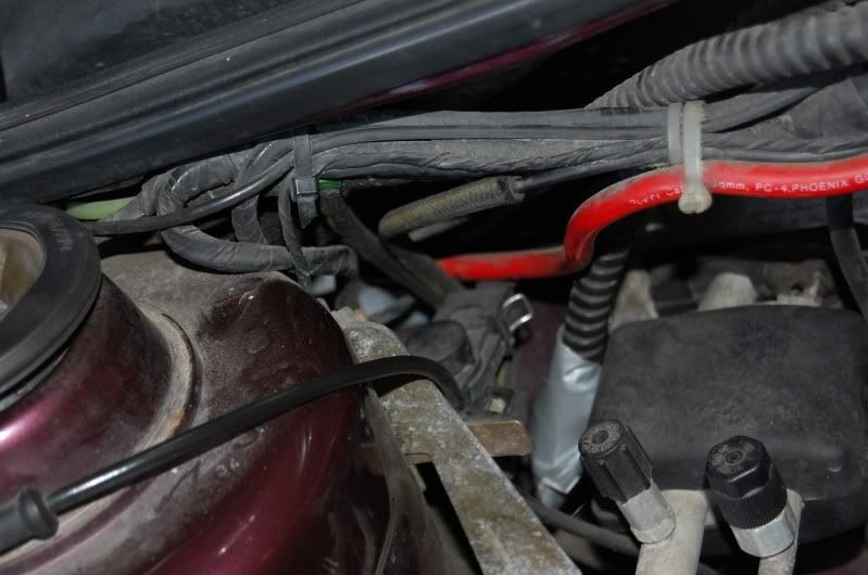

It seem to be going over to this area:
DSC_1582.jpg?t=1275392198

Ah a clue. On the LHD Corrado VR6 photo I have, THAT pipe turns into the scuttle wall between the two heater matrix pipes coolant pipes. There must be a loose plastic pipe inside the dash below the scuttle's floor panel.
Its part of the cruise control that goes to the vacuum vent/relief valves the pedals press and also the vacuum actuator unit that drives the accelerator. With it not connected, the crusie shouldn't work??? because there is no vacuum possible in the system to drive the vacuum unit on the accelerator.

You know what?
You where absolutely correct! - had a closer look, and for some weired reason I had absolutely overlooked the small vacuum plastic hose coming out between those 2 lines.!
