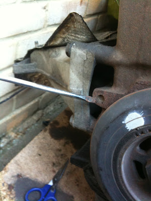

Well I've tracked it down! Looks like the sump was OK after all, it looks like it's coming from this hole: (ably demonstrated by my old engine).
What the heck is it and how do I stop Oil from coming out of it?!!!
HELP MEEEE! :clap:
looks either like a positioning or mounting hole - cant say i recognise it tbh :shrug: plus i would be concerned if the oil were to be coming from there as i dont think it connects to anything, so it really shopuldnt be a leak point. Perhaps give it all a good clean and try and locate the source again.
From what I've found out today it looks like it could be an engine bore plug that has corroded.
I can't find any reference to this happening before on a VR (just my luck) so I'm a bit stuck as to how to progress...
I've spent everyday/evening for nearly a month doing this so far, get to a point when I can actually drive it and this happens! My head hurts from thinking about it too much arggggghh :censored:
Yeah it does look like a core plug in the picture, where VW have plugged a machining hole at the factory. I could be wrong though, so I will check my block when I get home as it was rebuilt a few years ago, so should still be nice and clean down there :D
