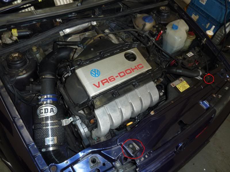

GlosterOx 0 Posted August 17, 2010 http://i147.photobucket.com/albums/r314 ... 6/rad1.jpg Is it these that you are referring to - If so, they were M6 x 15. Should still be available or just replace with St/Steel? Ian. Quote Share this post Link to post Share on other sites
GlosterOx 0 Posted August 17, 2010 Or do you mean these? download/file.php?id=83742&t=1 Ian. Quote Share this post Link to post Share on other sites
carrots 1 Posted August 17, 2010 the 1st pick mate Quote Share this post Link to post Share on other sites
Jon_vr6 1 Posted August 17, 2010 you can get them from vw for pence mate Quote Share this post Link to post Share on other sites
carrots 1 Posted August 17, 2010 what about the rubber washer spacer things and the bit my bolt snapped in Quote Share this post Link to post Share on other sites
Jon_vr6 1 Posted August 17, 2010 rubber mounting part number - 535 121 275 - £3.60 each Hexagonal head bolt m6 x 15 - part number - +N 010 215 27 - 26p each As for the metal bit the bolt is stuck in maybe you can get away with drilling the remnants of the broken bolt out so you can then put the new bolt through it, if not new ones are available from the stealers Quote Share this post Link to post Share on other sites
