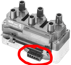

Can anyone confirm how many connectors there should be on a coilpack for a VR6?

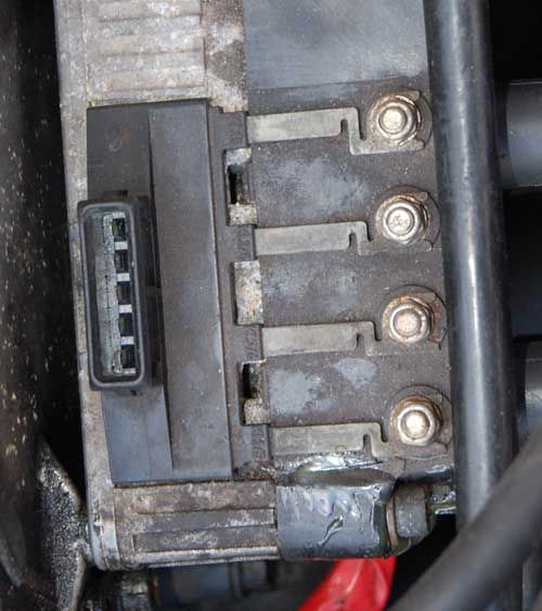

All the pictures of coilpacks on eBay seem to have 5. My car is 2 hours drive away so I can't check for myself at the moment but my dad has checked for me & is saying that my 'pack has only 4?
:scratch:
Unless he means the low tension side, which does have a 5 pin connector.
Ground, +12v, coil 1/6, coil 3/4 and coil 2/5.
But yep, definitely 6 HT outputs :lol:
EDIT: he did mean that, and yep, 5 is the answer.
