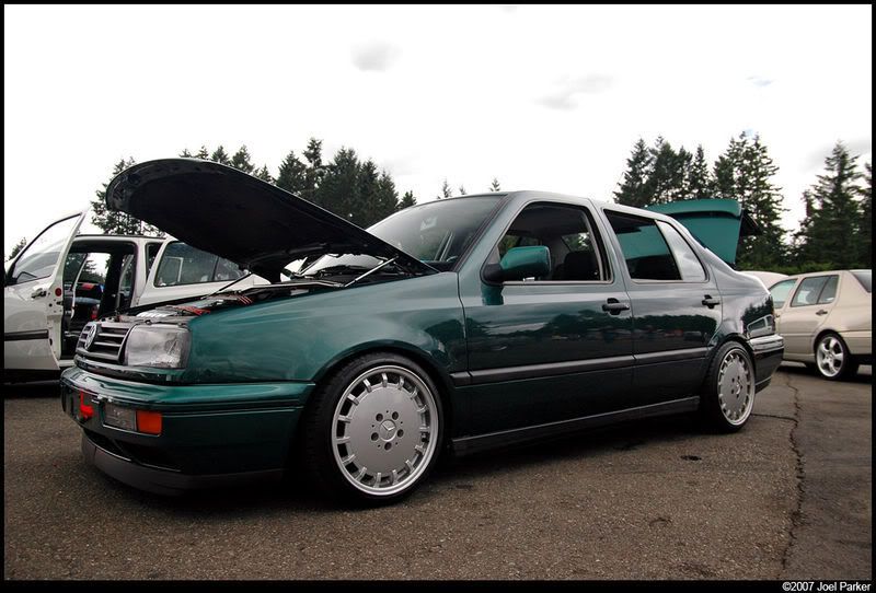

sixpotter 0 Posted January 3, 2011 Cool, I have the longer bolts just they are too small for the threads and too long for my 15mm front adapters.. think Im going to need 20mm at least anyway or get someone to take the ends off the bolts. The wheels I have are below: ...so it can be done I just appear to have ballsed up adapter sizes presuming there are 2 types of the same adapter? Quote Share this post Link to post Share on other sites

n3p 3 Posted January 5, 2011 I may be wrong, but I'm not sure if there are adapters available which have both the M14 holes for the VW hub (in 5x100) and M12 holes for the merc? (5x112). I was close to getting some merc wheels a while back before the seller let me down...after scouring through various forums it seemed that drilling the alloys bolt holes out to 14 was the most common solution. Some used stud conversions like those in the link I sent you although I'm not sure which one you would go for. Local machine shop quoted me £10 per wheel, although it seems that some people just did it themselves with a drill bit :nuts: In a way I'm glad that the seller let me down...the wheels I ordered were 16x8J ET34 :shock: with the adapters it would have been painful :lol: The wheels in the pic look great though, if I were you I'd bite the bullet and get them holes opened up! Nick Quote Share this post Link to post Share on other sites
