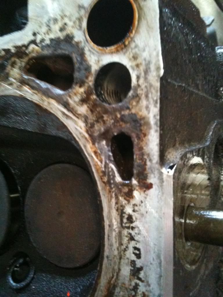

Hello. I took a g60 from a mate as a favour as it needed a head gasket. The head is now off and it looks like it might be the head it's self rather than the gasket. Can anyone tell me the differences between and 8v and a g60 head? As I am in need of one.

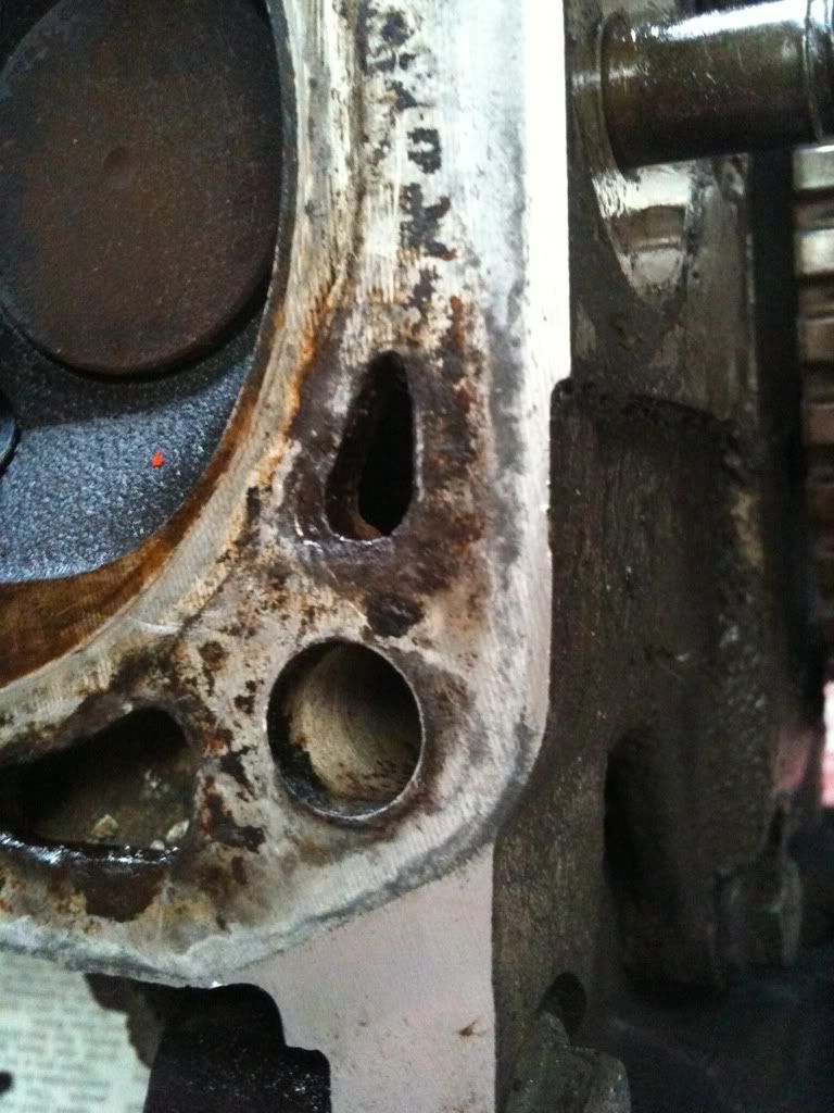

So the reason for asking is this. See below. I am wondering weather the corrosion can be skimmed off. I have found another 8v head. But from the looks of it it has already been skimmed to the point that I'm honking of taking this one.
Has anyone had similar troubles. And what is the max you have ever heard of being skimmed?
Thanks again
Sorry for the links not images. I can't re size them on my phone at work.
http://i357.photobucket.com/albums/oo19 ... 1dca8d.jpg
http://i357.photobucket.com/albums/oo19 ... 690e3b.jpg
