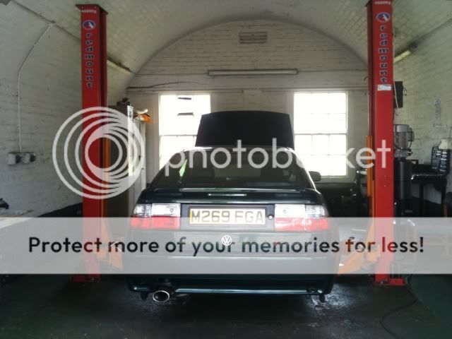

Hi all,
I've stripped my coilovers off of the car this morning and all is not good. See Below
I'm hoping somebody out there has had this problem before, I'm going to have to order new collars, I've tried Venom Motorsport but they say it'll take 2-3 weeks to get hold of them.
If anyone can help please get in touch as my car is now stuck on a ramp
