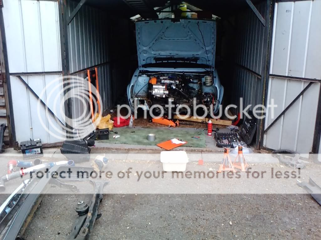

With no help i set about removing my G60 engine armed with nothing but a halfords professional tool kit and a small tool box (the sort of tool kit the mrs keeps around the house for small bits and bobs)
I arrived at 11ish and got stuck in.
All went pretty well actually and made good progress. Had to nip over to halfords and buy a cheap "lift kit" as the call it. Comprised of trolly jack, axel stands, wheel blocks and a padded car creeper.

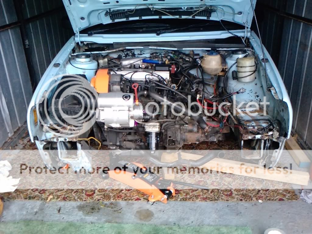

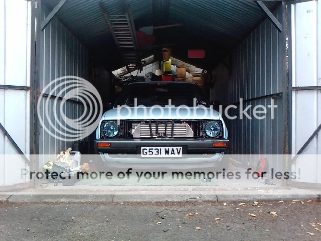

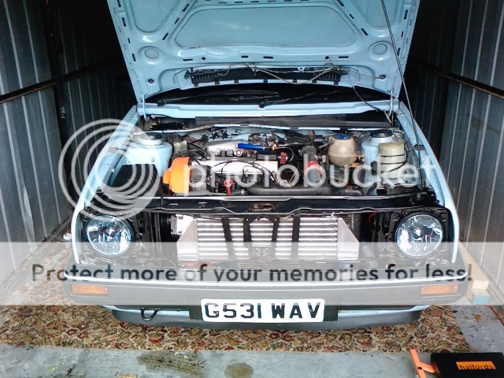

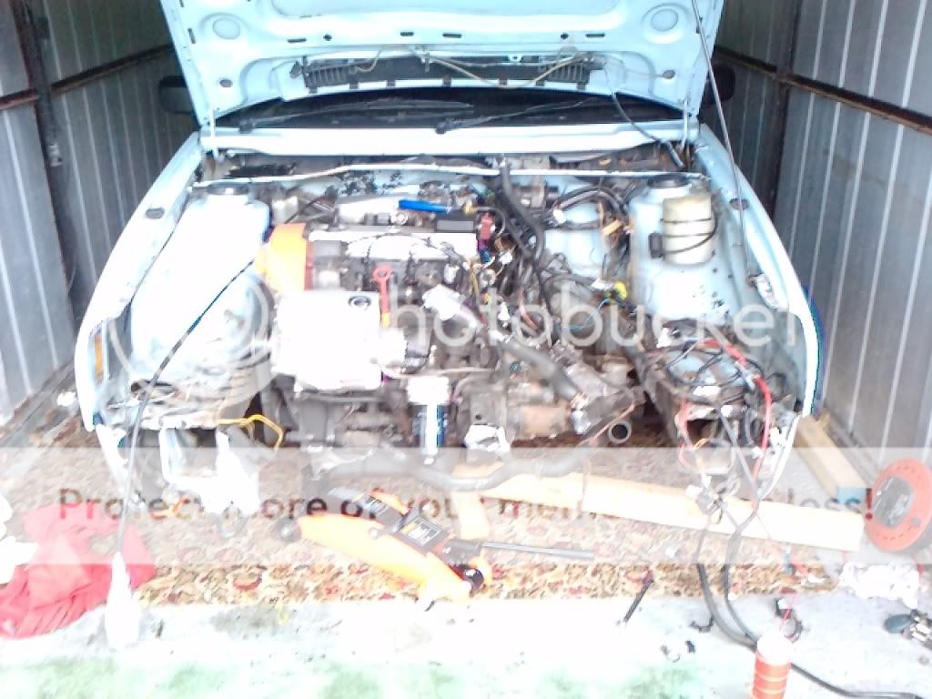

front end off i have good access to all the hard to reach sensors.
Wiring was something i was worried about on the journey over to the car. I've never done anything like this before so didn't know what to expect. I've removed the charger on the car and changed a set of break pads before so this was set to be an interesting experience.
I like to think i'm a logical thinker and after a few head scratching moments i managed to sort as much as poss with the engine still in situ.

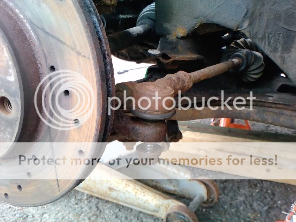

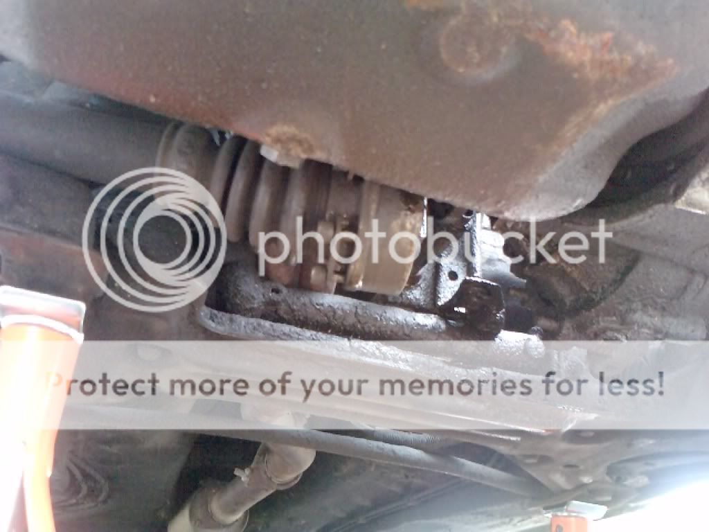

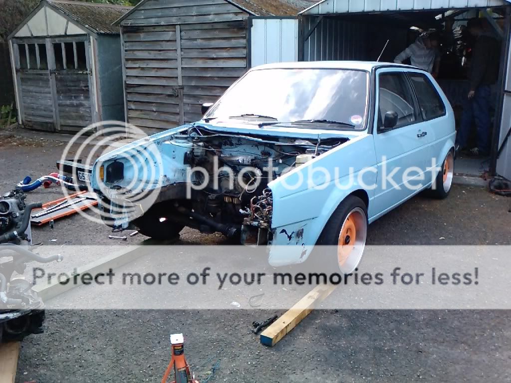

I was going to pop out the drive shafts but all my suspension (if completely honest) was well overdue an update and everything seemed to be stuck solid.
The boot looks a little twisted aye :rolleyes:
Anyway a bit of encouragement from mr lump hammer and it gave up the ghost. Wasn't too fussed about being a bit heavy handed as it's all going to be replaced for nice new stuff during the conversion.
During the day i was phoning round trying to source parts to aid me with the removal.

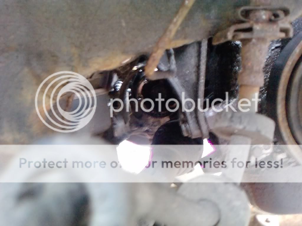

A trip to Exeter GSF later i had a 12 spline 800mm bar to remove the 6 drive shaft bolts each side. 1st side went perfect but passanger side bloody rounded off so out came mr lump again. :) out they came.

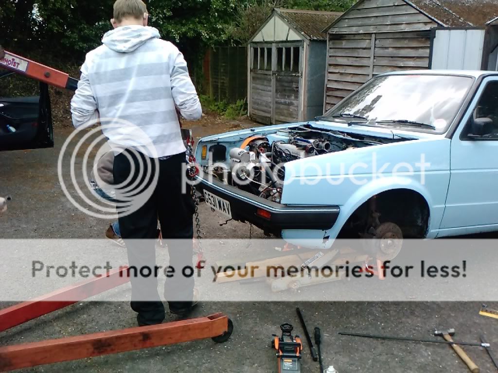

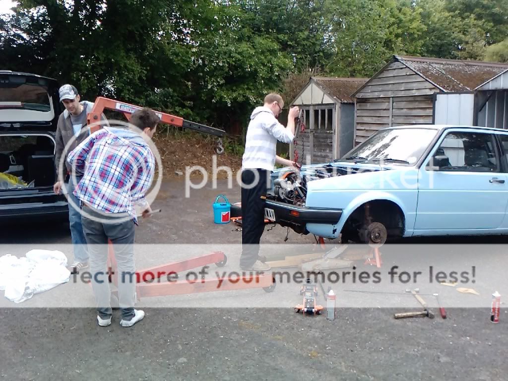

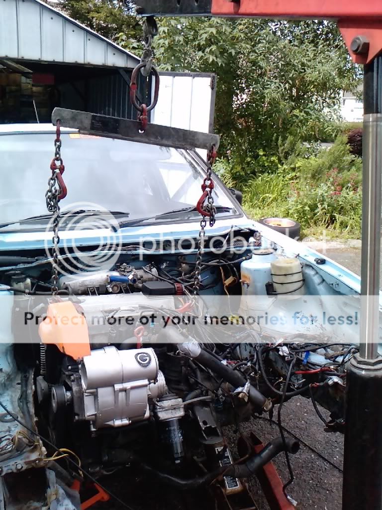

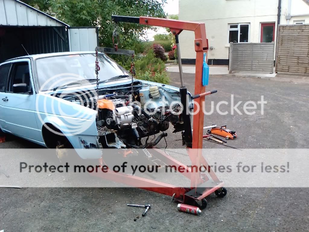

thankfully a few calls and a few favors later 3 kind mates turned up with an engine crane borrowed from Ford (haha thanks Ford)

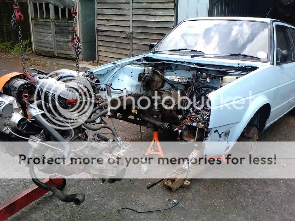

As you can see in the pic, instead of supporting the engine under the front when putting it up on the axel stands i decided to put the front crossmember back in and get the crane to support the whole engine after this was back on. Then i took the front cross member back off.
Then the moment of truth, fingers crossed. This was probably when i come across other things i'd forgotten to undo.
Nope....it just slid straight out!! HAHA, happy days and time for a fag :thumbleft:
It worked quite well, i undid the downpipe in the centre and thought we would have to riggle the engine around to lift off the studs but when i undid the rear engine mount the engine dropped at the front and it popped off.
The dreaded wiring proved to be me worrying about nothing. 10 mins and i had removed a couple of bits and bobs QPENG advised i need to keep and it was out.
WoW, didn't think it would be out so soon, not bad considering my lack of experience. Well i like to think so anyway :cheers:

Seems strange looking at bits of my car in your pics! The intercooler looks sweet in place.
Good work ad
thanks guy, yeah the fmic looked pretty good with the grill off......to be honest i didn;t put it back on :cool:

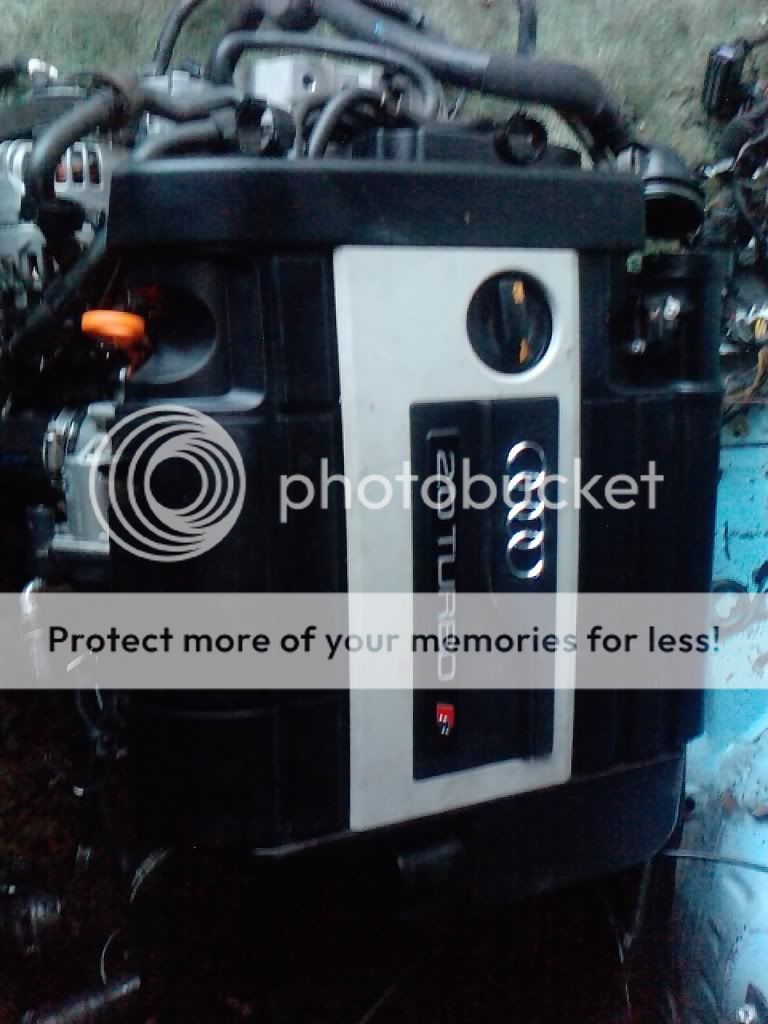

Picked up my new TFSI lump at the weekend. I use the term picked up....this makes it sound as if i just popped round the corner to pick it up.

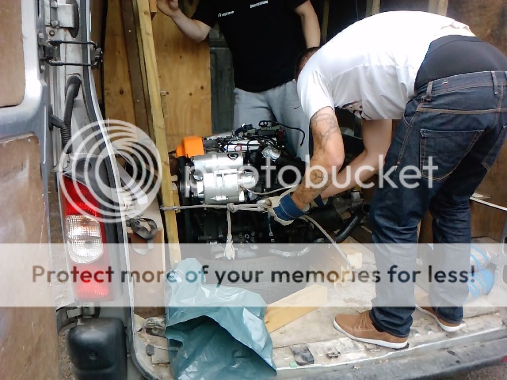

Note the TFSI lump in the boot, i cut out the pin that holds the spare wheel in place. Put an old tire in the wheel well and it sat in there lovely. Although we did have to lean it to the side to stop the turbo's outlet pipe getting squished. Strapped it in and it was good to go, lol.
The guys face was pricless when he was looking round for a van, then it occured to him i was opening the boot of the car for the engine to be put in.

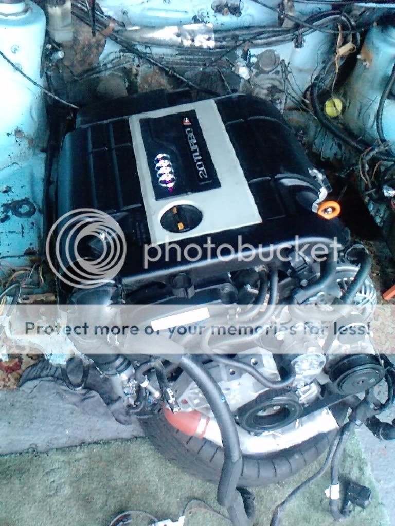

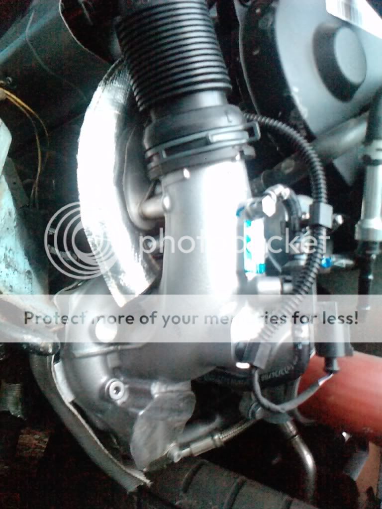

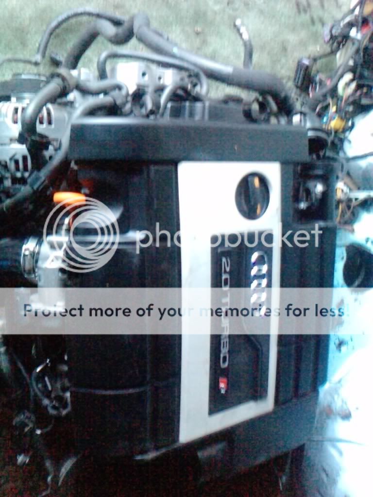

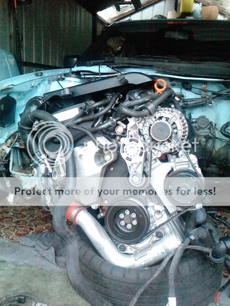

Anyway this is the engine back at home sat next to my mk2's engine bay.
Also got the whole loom, clocks, ECU, both fuse boxes and bluetooth unit.
Still got loadsa bits to get but i'm excited that i've got the whole engine with only 1200miles and all the auxiliaries.

What engine code is on that one? take it its a s-line engine
CDL S3 engine (265bhp) :)
