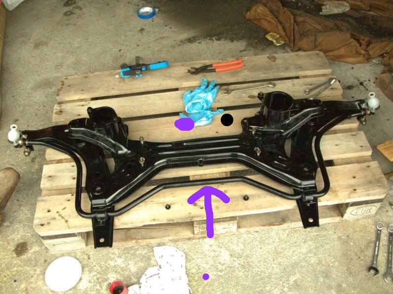

After the rebuild I'v noticed much more "shivering" in the car, and just recently found out that the bar that goes on the back of the subframe hits the downpipe.......I belive this to be the cause of the shivering I can feel around the car.

the purple arrow shows where it hits.....

By bar, do you mean the anti-roll bar? Can't see the pic as it's hosted on a storage site, but I'm guessing the ARB is fitted upside down....
yea, it's the anti rollbar.
AFAIK it's the correct way - but feel free to have a look (I think this was one of the things I looked into when re-assembling it).
Uploaded the pic:
(if you can view it)......
Well the arrowed bit does look like it's pointing down rather than up, but it's hard to say for sure looking at that angle.

Yeah it is possible it's upside down because that makes no difference to how it looks at the drop-link end. The *only* time I've seen an ARB hit a downpipe on the VR was because the ARB was upside down. When fitted to the car and jacked up, the arb where it passes under the exhaust should be well below the steering rack.
Alright - I'l have a look into that, as that's pretty much the only thing that makes sens it seem :)
thnx again.
I can (not so proudly) confirm that it's absolutely possible to put this bar in upside down....lol.......
