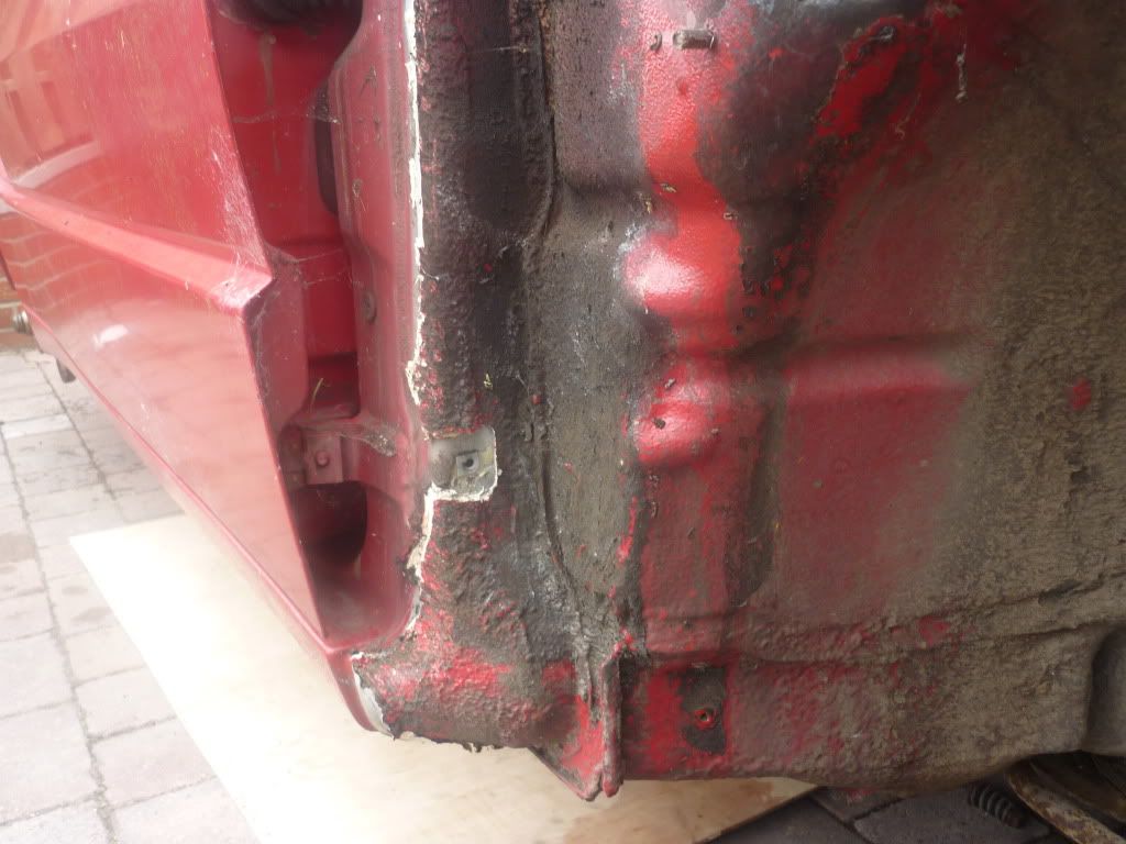

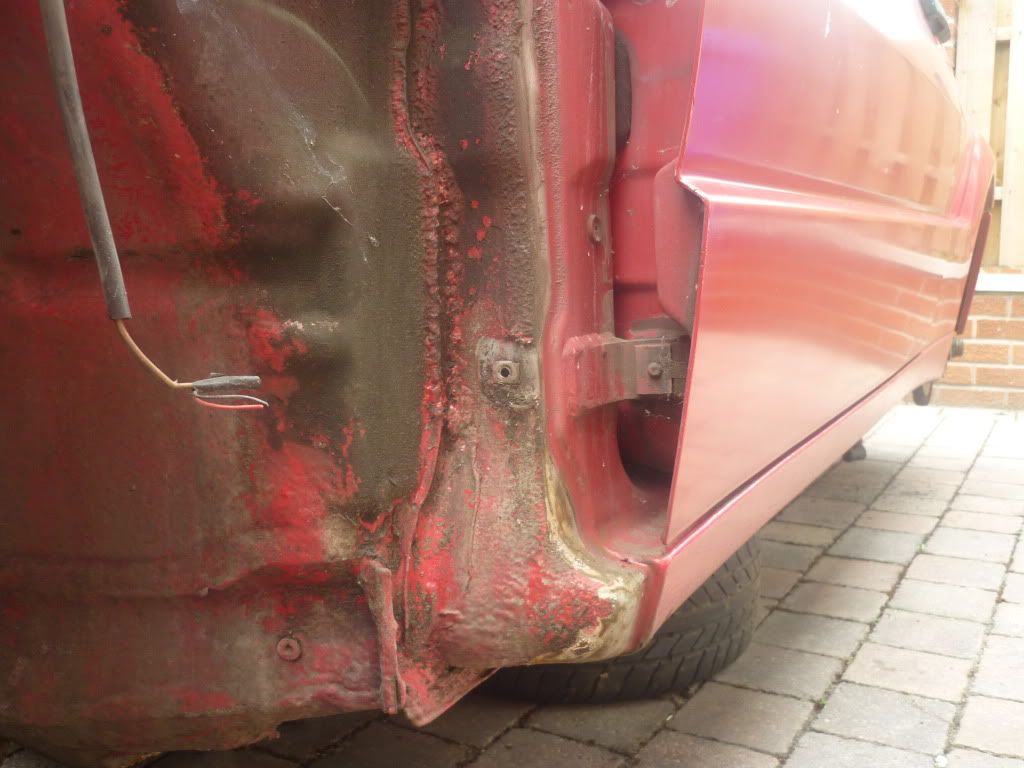

Matt-vr6 10 Posted August 22, 2011 is it these bits your after Quote Share this post Link to post Share on other sites
Matt-vr6 10 Posted August 22, 2011 is this what you mean Quote Share this post Link to post Share on other sites

Jim Bowen 1 Posted August 26, 2011 thats £109 just for the bit of metal, i got a rear qtr for my escort for under £20 :lol: ---------- Post added at 10:59 AM ---------- Previous post was at 10:58 AM ---------- is it these bits your after yes they are the bits, is that a car your scrapping? have you poked around to see if they are rusted at all, i need the front curvy shaped bit and then about 12 inch of where it returns under the sill Quote Share this post Link to post Share on other sites
