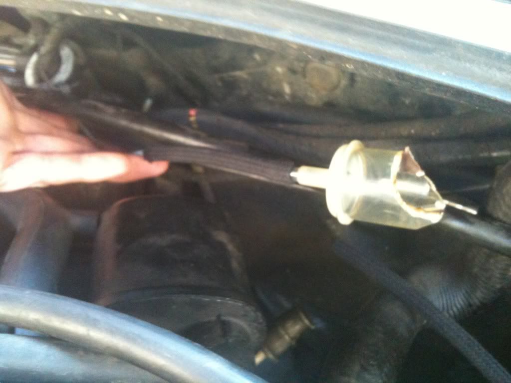

rubberdubber 0 Posted September 30, 2011 here it is, looks like a inline fuel filter but has no filter inside. the rest of it is melted onto the manifold! ha! but there was definately no filter inside it, just hollow. this pipe then goes into the car through the bulkhead. any ideas? cheers chaps :) ---------- Post added at 06:00 PM ---------- Previous post was at 05:59 PM ---------- 1 side goes through the bulkhead, the other pushes onto the brake servo hose cheers Quote Share this post Link to post Share on other sites

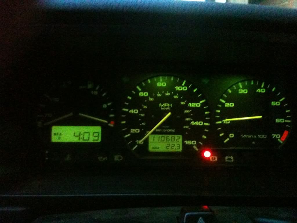

RW1 0 Posted September 30, 2011 Post picture up of your clocks in the dash please. . Quote Share this post Link to post Share on other sites
rubberdubber 0 Posted September 30, 2011 here is a frontal view of the cluster, am taking the dash out to do the matrix tomorrow so can get one from behind too. Quote Share this post Link to post Share on other sites

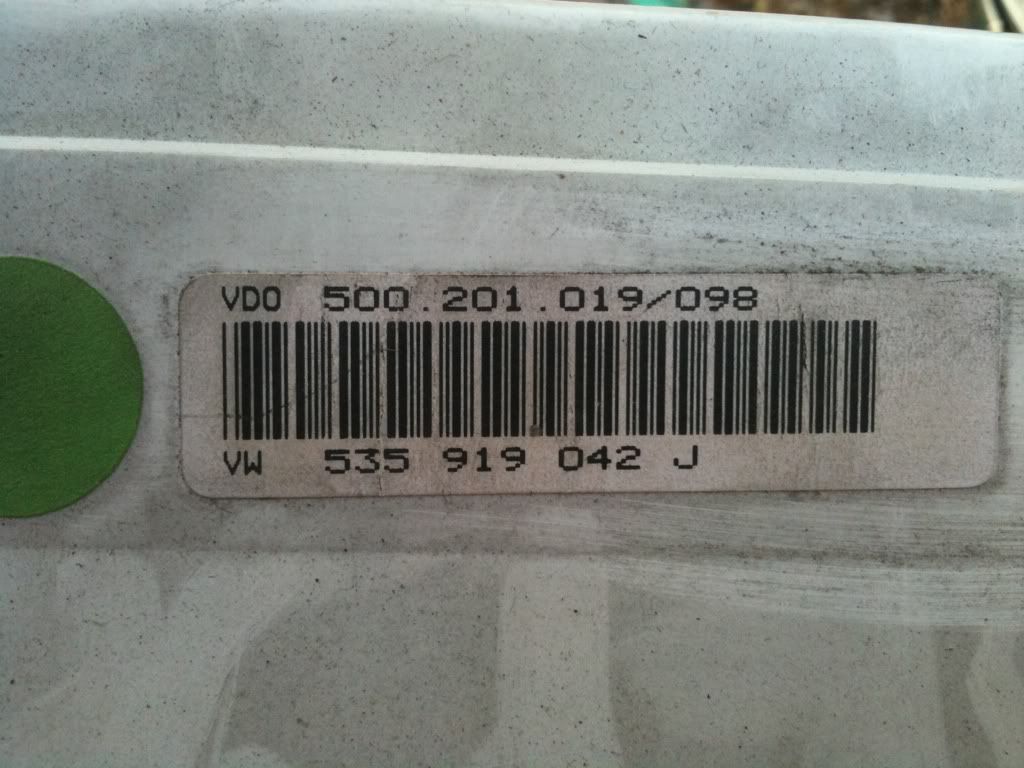

RW1 0 Posted September 30, 2011 Interesting, not what I expected. Yes, the back would be usefull and the part number on the white sticker, usually above the speedo on the white back casing outer top face. . Quote Share this post Link to post Share on other sites
Kevin Bacon 5 Posted September 30, 2011 God knows what that melted bit is mate but it's not a standard VR6 part! Looks like one of them inline fuel filters for carburettor engines that's been gutted internally! Quote Share this post Link to post Share on other sites
24V Renshaw 0 Posted September 30, 2011 Almost as though someone has fitted early clocks and made them work on the VR.... Jay Quote Share this post Link to post Share on other sites

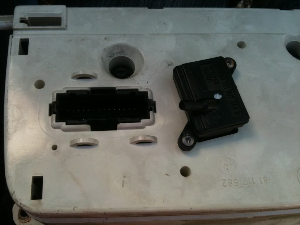

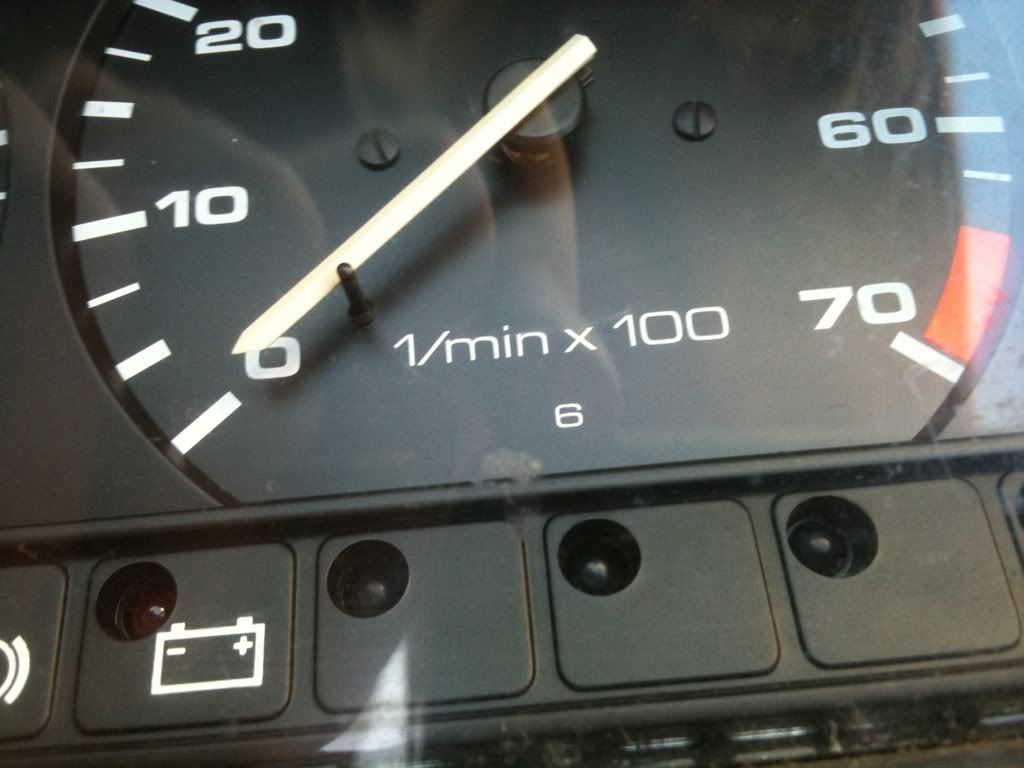

rubberdubber 0 Posted October 1, 2011 heres some pics, definately vacuum controlled and the 6 on the rev counter would indicate v6 clocks. hmmm... Quote Share this post Link to post Share on other sites
RW1 0 Posted October 1, 2011 Genuine VR6 clocks! What suggest you do with the broken part is just substitute a large petrol filter as bought and connect the two end pipes to it. The internal filter won't matter as it will remain clean and therefore free flowing. Why its fitted? Most vacuum MPG connection to the brake servo pipe don't have it. Most likely use to dampen the surges in vacuum on the VR6. Maybe found something wrong with the readings the system was giving on the VR6. If it serves that purpose you will soon find out with MPG readings in the stored memory (kept ones) reading incorrectly. The substitute tubing you have used needs to be a rigid type that won't collapse. There is upto 1 Bar (15 psi) vacuum in the pipe. The black unit on the back of the instrument panel is quite expensive at £150ish, and is common to other engines like 8 valvers. So rather than develop a new part to solve, they made do with an additional part to overcome the short comings on the VR6. Knowing the engine ECU would take over the MPG in later cars, to develop of a new vacuum sensor for a short run may not have been cost economical. Who knows :shrug: . Quote Share this post Link to post Share on other sites
rubberdubber 0 Posted October 3, 2011 cheers man, i was thinking fuel filter, wasnt sure if the vacuum would travel through the filter. ile give it some miles and see how it is with and without a fuel filter. glad there vr6 clocks was beginning to wonder if i had abit of a mismatch ha! Quote Share this post Link to post Share on other sites
