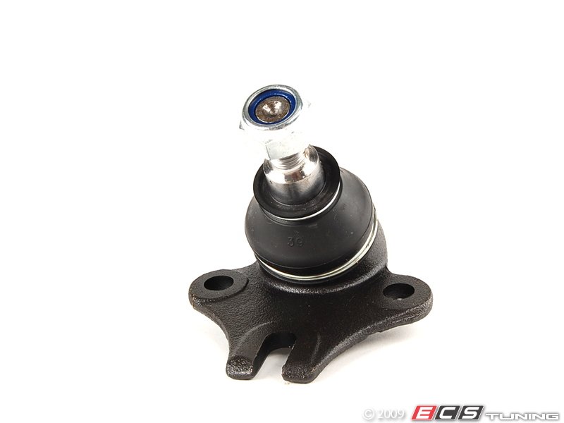

I think i can see some of the differences betwee the 4cyl and 6cyl LBJs. This is the VR item I think:
so instead if having a recessed groove all the way around which a bolt sits in to hold the LBJ in place, it torques up into the bottom of the hub and I guess that tapered shoulder provides an interference fit?
If you think about it, lowering the car by 40mm lowers the inboard pivot point of the wishbone by 40mm, so to get the wishbone back to stock position you need to extender/lower the outer pivot point (i.e the lower ball joint) by the same amount, 40mm.
You are bang on about how the VR ball joint works, now try and come up with a simple extension... :)

You could probably make a small part which had an interference fit from LBJ > extender, and also extender > hub, but it might be a total ballache to remove.
Using the pic above, perhaps something a little more complex with tabs that reach down to the most outboard LBJ mounting holes (not the slot) but this would increase manufacturing costs. I think a simple cylindrical design which can be lathed from a solid billet would be the best idea.
