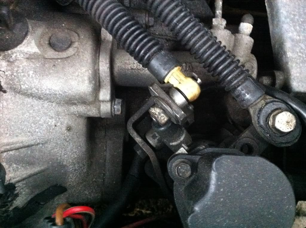

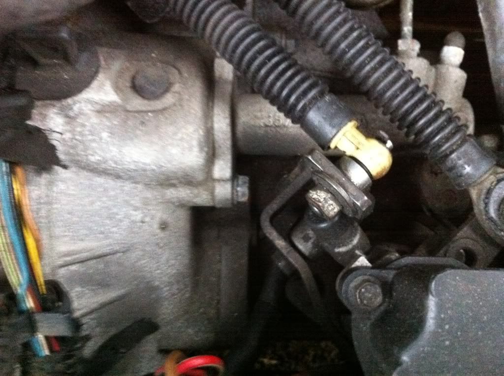

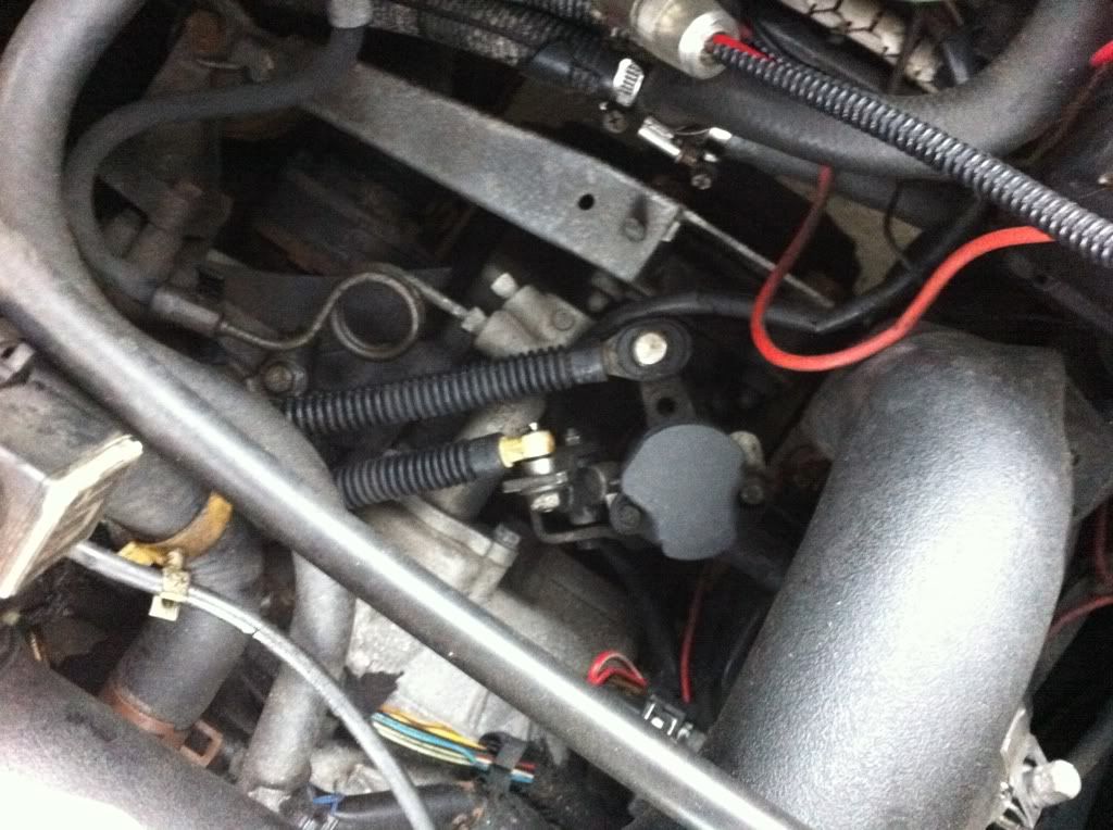

bmcc 10 Posted October 22, 2011 thats pic of bit under bonnet, piece on left seems to have a little bit of play in it, ie i can shake it from side to side, should this be stiff? Quote Share this post Link to post Share on other sites
owen g60 10 Posted October 22, 2011 just checked mine... they are solid, so it does seem that something isnt right there for you Quote Share this post Link to post Share on other sites
bmcc 10 Posted October 22, 2011 seems to be like the underside bracket bit that has play in it, dont know if its missing any plastic pieces etc Quote Share this post Link to post Share on other sites

bmcc 10 Posted November 10, 2011 there definitely is a lot of play on piece that is attached to gearbox, i dont know if a pic of another g60 bay maybe be able to see better, as pics i posted arent the best Quote Share this post Link to post Share on other sites
