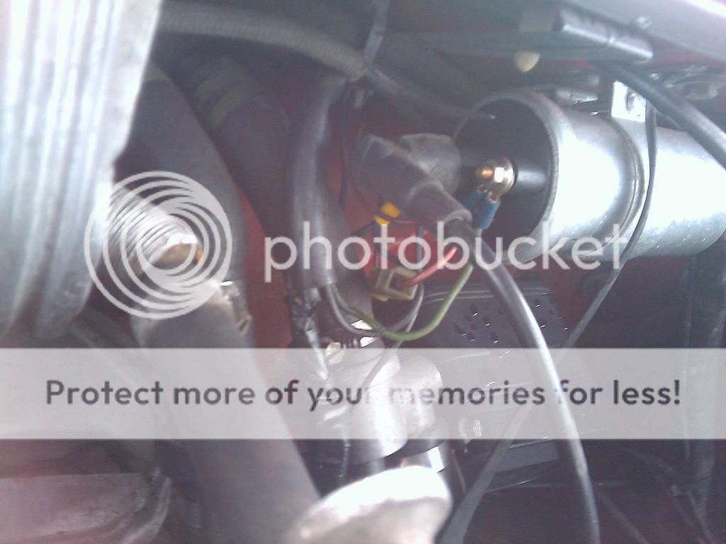

found some funky wiring around and to the coil, im guessing its to do with the immobilizer being removed..it goes from the coil to the engine and into the loom..i need to know if i can remove it?? the car runs fine and central locking is fine.....i just dont want the wiring there if it ant needed...

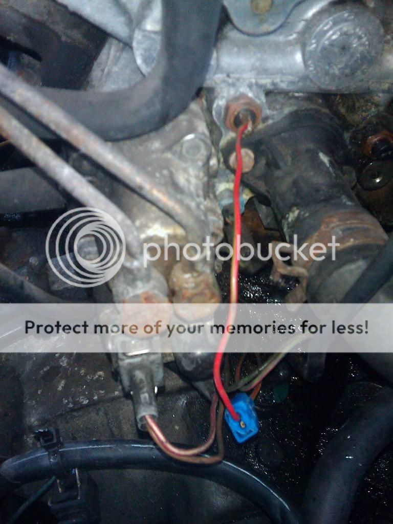

this one has some taped wires..on it a earth to the engine...the others go into the loom but it ant standard

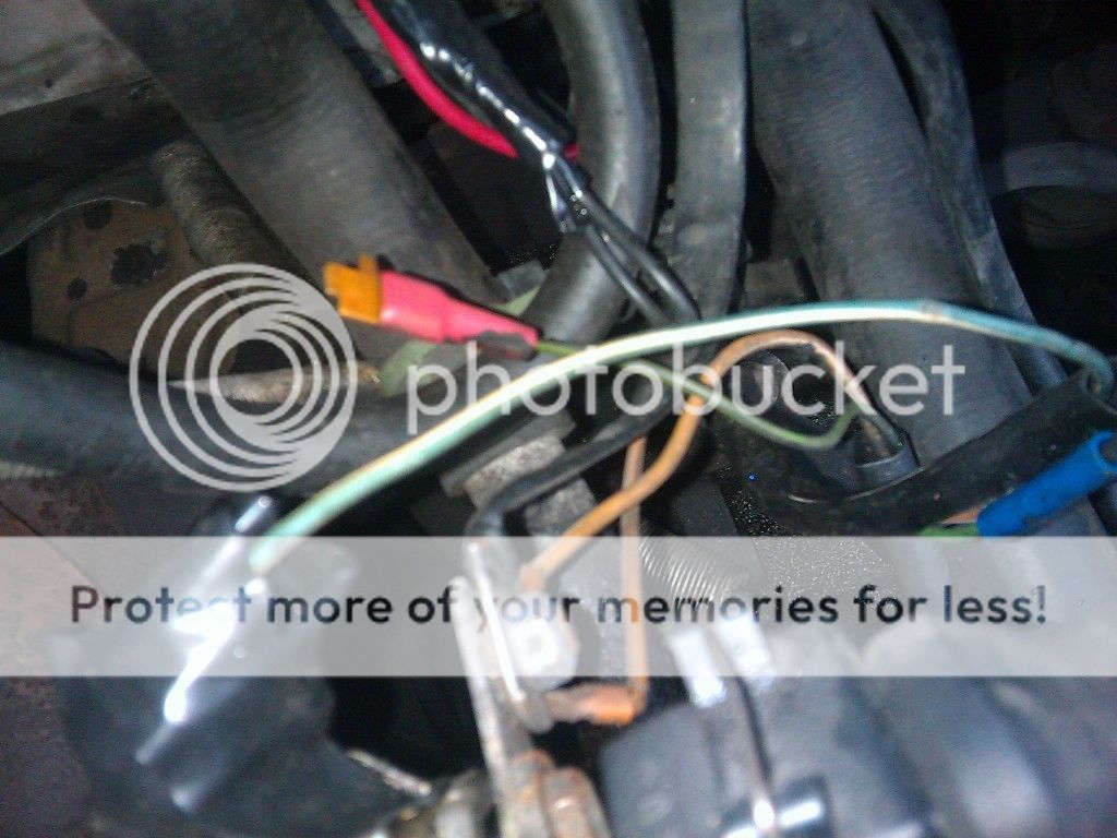

this one is on the side of the engine, it goes from the loom to a sensor...

Pic 2 should be there, it's one of the sensors, I think temperature gauge, Ithe loose terminal in pic 3 has broken away from the sensor on the right of pic 2 by the looks of things. May be totally wrong of course. Last is id a spare connection and just sits there annoying people.
No, a single wire. There are three sensors on the side of the head there, all the same. One for the temp gauge, one for the idle control unit and one for the ECU. The two wire connector in pic 2 is for the WUR.
Looking at pic 2. If you follow the red wire down about halfway you can see the lower sensor behind it with what looks like a green wire with black connector. Now look at the red wired sensor again. Over to the right just on the edge of the pic you can see the other sensor, looks like a brass nut. It looks as if the connector has broken off, which is incredibly similar to the wire shown in pic 3. There is also an oil temp sensor on the back corner of the head with a similar connection to these which may be worth a look.
The red wire in pic 1 looks a bit dodgy with the snaplock connector and would benefit from a bit of solder or replacement.

Can't remember off the top of my head, but I think they're under £15. New ones may have a flat top that the connector slides onto rather than the prong type in your pics. The three of them are the same.

cheers guys.....think ill have a look in a scrap yard first as i need the large on on the top next to the distributor, and both top coolant ones...ive took the wiring apart and found its not as bad as it looks, but i would like you guys to have a look before i do anything....

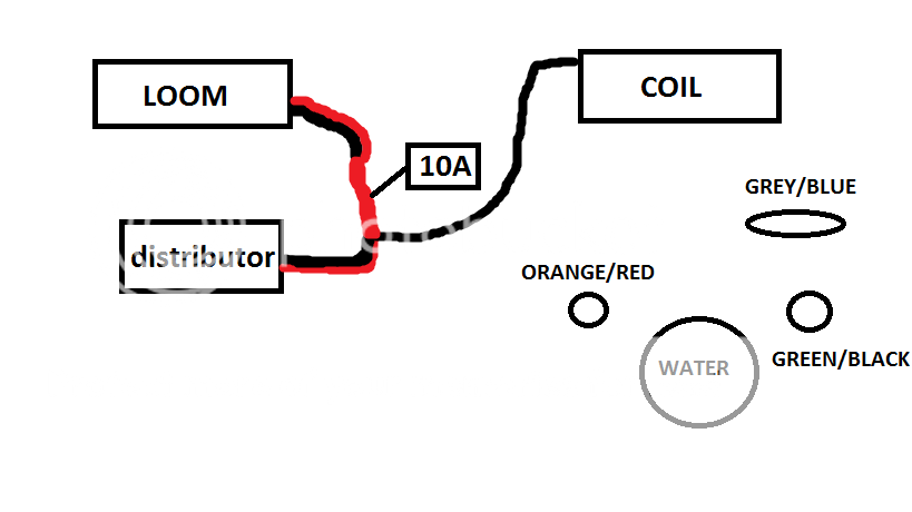

the wiring to the plug on the distributor is a easy fix..ive sorted it....but the wiring from the coil has me stumped....heres a diagram....wires are coloured..the bit on the bottom right are the water sensors.....also i have no oil temp reading on the dash...
